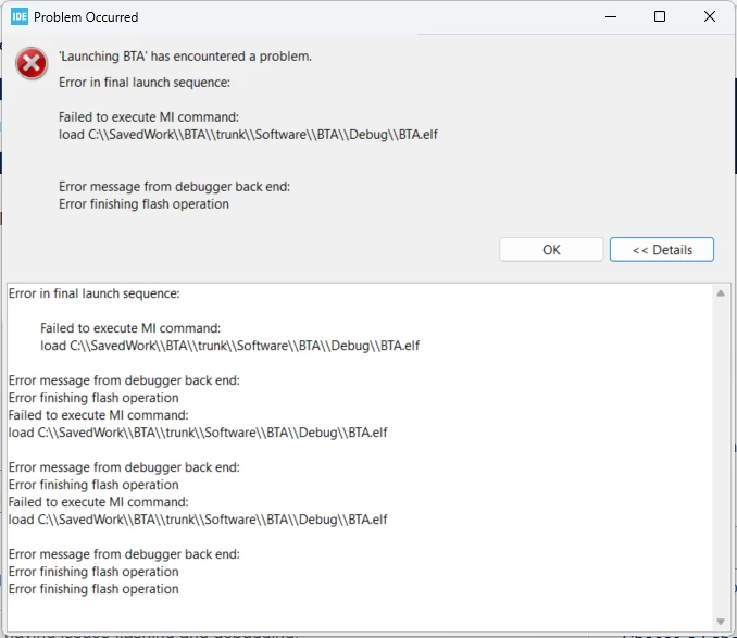

I am using the Nucleo-L433RC-P board but having difficulty flashing and debugging.  9 out of 10 times I get the following error...

Error: Data mismatch found at address 0x0800A4E1 (byte = 0xC0 instead of 0x00)
Time elapsed during verifying operation: 00:00:00.277
Error: Download verification failed
Encountered Error when opening C:\ST\STM32CubeIDE_1.18.1\STM32CubeIDE\plugins\com.st.stm32cube.ide.mcu.externaltools.cubeprogrammer.win32_2.2.200.202503041107\tools\bin\STM32_Programmer_CLI.exe
Error in STM32CubeProgrammer
Shutting down...
Exit.

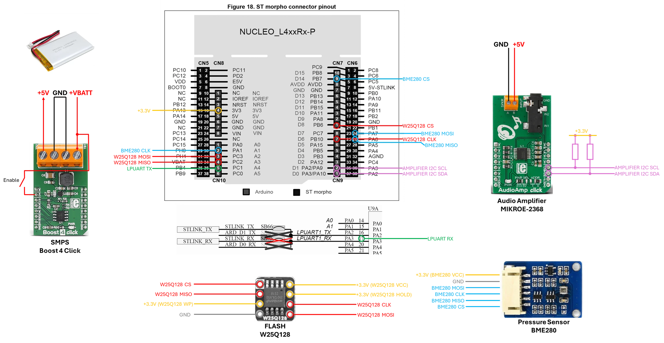

Methods I use to try and get it working is:
  • Disabling 5V power (see setup diagram below),
  • Disconnecting the USB
  • Restarting STMCubeIDE
  • Deleting the Debug folder
  • Disconnecting other interface boards (see setup diagram below)
Then 1/10 times it will suddenly work.
This problem originally started when I tried to retarget the MCU from an STM32L433RCTxP to STM32L433RCTx.
I did this by editing the .ioc file and changing any reference of STM32L433RCTxP to STM32L433RCTx.
I have since gone back to the original MCU used on the board (i.e. STM32L433RCTxP), but having great difficulty in flashing and debugging.
I even created a new, clean project for the Nucleo-L433RC-P board, but the issue still exists.
I have other interface boards connected to the Nucleo-L433RC-P board and have tried disconnecting some of these in case they are interfering with the operation.  Sometimes it makes a difference, but other times it does not, so it could just be coincidence.
Below is my setup...

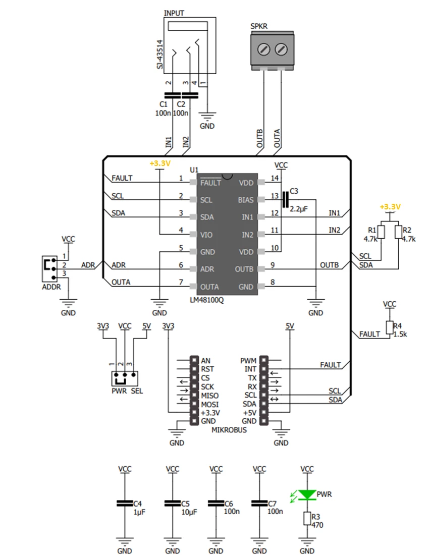

For example, the audio amplifier is powered by the 5V SMPS, but even when the SMPS is disabled, the +3.3V from the Nucleo-L433RC-P board (which is used for I2CVDD pin and IC2 pull up resistors) seems to somehow power the amplifier (LED on and audio plays).
Why am I having such difficulty flashing and debugging and how to I resolve it ?
Is the Nucleo-L433RC-P board damaged or are my interface boards causing an issue ?

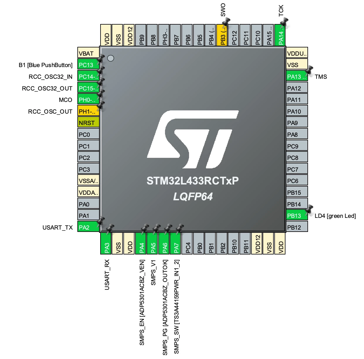

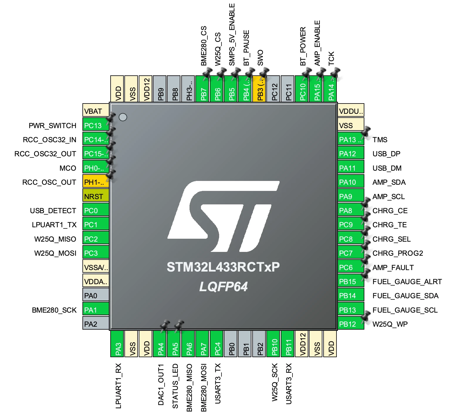

A clean project for the Nucleo-L433RC-P board uses the following pin out...
But my project does not use the external SMPS and I have re-assigned the pins:
  • PA4
    • Was a digital output (SMPS_EN)
    • Now an analogue output (DAC1_OUT1)
  • PA5
    • Was a digital output (SMPS_V1)
    • Still a digital output (STATUS_LED)
  • PA6
    • Was a digital input (SMPS_PG)
    • Still a digital input (SPI MISO)
  • PA7
    • Was a digital output (SMPS_SW)
    • Still a digital output (SPI MOSI)
Could these changes have caused any damage ?
Because it still doesnt flash or debug even if I swtich to a clean project for the Nucleo-L433RC-P board
Can the Nucleo-L433RC-P board be used without the external SMPS ?
