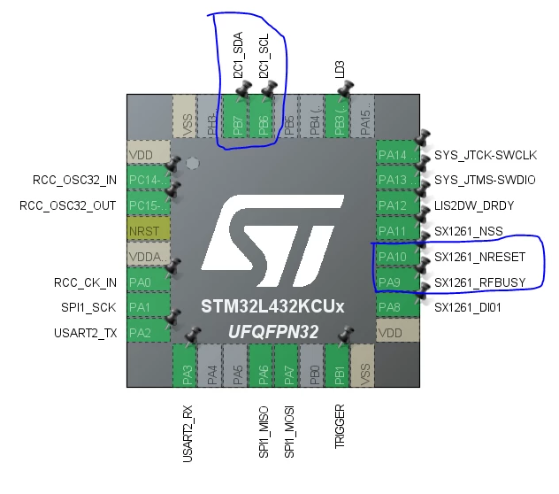

Thank you! i checked the UM1956 manual and cant find anything about the pins beeing connected..
iam using i2c1 to communicate with a sensor.
When i set PA10 to LOW, the I2c Communication crashes and my sensor output jumps to 0.
I thought the pins are connected and iam "overwriting" the i2c communication with my GPIO?
what could be the problem?
waclawek.jan
Aug 18, 2020 11:06 AM UTC
Isn't your sensor reset by PA10 (SX1261_NRESET)?
UM1956 says that PB6/PB7 are connected to PA5/PA6 through SB16/SB18. Make sure PA5/PA6 are set as input (read out GPIOA_MODER and check).
Other than that, I don't know.

well not really .. i mapped my GPIO pins (RFBusy,NRRESET) so other pins of the L432. this did not solve my problem.
I solved this by toggeling a random GPIO pin (i used PB1) before reading the I2C interface..
i dont know why this works, but it does ...
