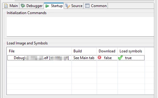

I'n not quite sure how to attach the debugger without also reflashing. If I uncheck 'download' from the startup tab in the debugger configuration, I cannot connect to the ST-link it seems. The console shows the following:
Starting server with the following options:
Persistent Mode : Disabled
Logging Level : 1
Listen Port Number : 61234
Status Refresh Delay : 15s
Verbose Mode : Disabled
SWD Debug : Enabled
InitWhile : Enabled
Waiting for debugger connection...
Debugger connected
Debugger connected
Andrew Neil
April 11, 2025

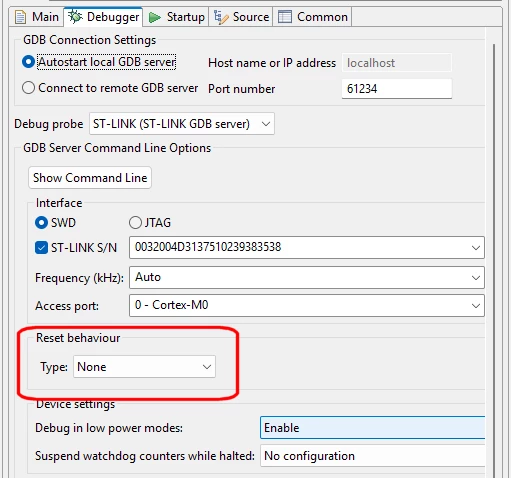

Yes, setting 'Download' to false on the 'Startup' tab should do it.
You'd also want to disable the reset on connecting:
Does your code go into low-power mode, and/or reconfigure the SWD pins?
