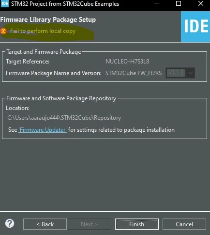

Hello @FBL i edited my post to include project on attachment. I have tried to import the cdc standalone to the STM32CubeIDE but it kept giving me an error copying(image). So i opened it manually. I am still not sure how to compile this multi project and upload to the board eve following the um3294 steps. Thanks for your help!

Hi @andr3
This is known issue, similar issue in this post Fail to perform local copy - STMicroelectronics Community
Try to run the example manually from direct path
