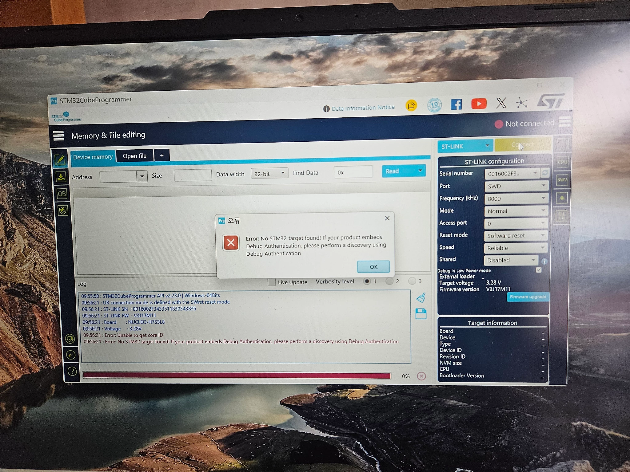

A customer raised a quality issue since the MCU on the NUCLEO-H7S3L8 fails to connect.
Issue Description: While the onboard ST-LINK is detected successfully and target voltage is correctly measured, the main MCU fails to connect as in the attached picture.
Application Description: Attempted to connect the board and upload a program using the official STM32CubeProgrammer software after powering up.
I was able to find one post having the same problem, but the dev board is different
https://community.st.com/stm32cubeprogrammer-mcus-30/error-no-stm32-target-found-smt32n657x0-q-145776#M7723
I think the solution provided in the post would work for NUCLEO-H7S3L8 too, but since they are different boards, it seems the way to enter Dev BOOT mode would also differ.
Could you please check the customer's situation and provide a troubleshooting guideline?

Hello Mike_ST,
I'm not an expert in this field, but these posts seem to be related to STM32H7 IC design. Since the question is about an issue occurring on the NUCLEO-H7S3L8 development board, I would appreciate a detailed explanation of the troubleshooting steps or actions that can be taken on that specific board.

Hello again,
In the 2 articles I linked in my previous post, are step by step instructions to attempt exiting a lockout situation on STM32H7 range of ICs.
This can help for the NUCLEO-H7S3L8 development board where you can run into this situation as well.
