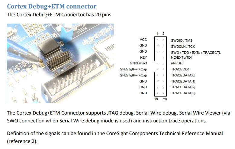

Hello Everyone,
I have the Nucleo-H7S3L8 as my first STM32 board.
I want to connect it to a Segger J-Link Pro for JTAG. In the official documentation (https://www.st.com/resource/en/user_manual/um3276-stm32h7rx7sx-nucleo144-board-mb1737-stmicroelectronics.pdf), the board supports JTAG debugging through the MIPI20 connector CN1 (7.3.3 on page 14). For a more detailed view, see Figure 4 on Page 10.
I am looking for a way to connect MIPI20 (male pins) to the ARM-20 pins on the J-Link. Is there a way to connect the two?
It's just a pin header - you can check details in the BoM.
You just need to wire the necessary pins from that header to the corresponding pins on the J-Link.
Nothing special required.
You should also find that the necessary debug pins (SWDIO,SWCLK,NRST) are available on the "Morpho headers" - so you could wire to them...
You could ask Segger if they have a suitable adaptor...

PS:
It looks to be compatible with the Standard ARM Cortex Debug+ETM pinout:
https://documentation-service.arm.com/static/5fce6c49e167456a35b36af1#page=2
