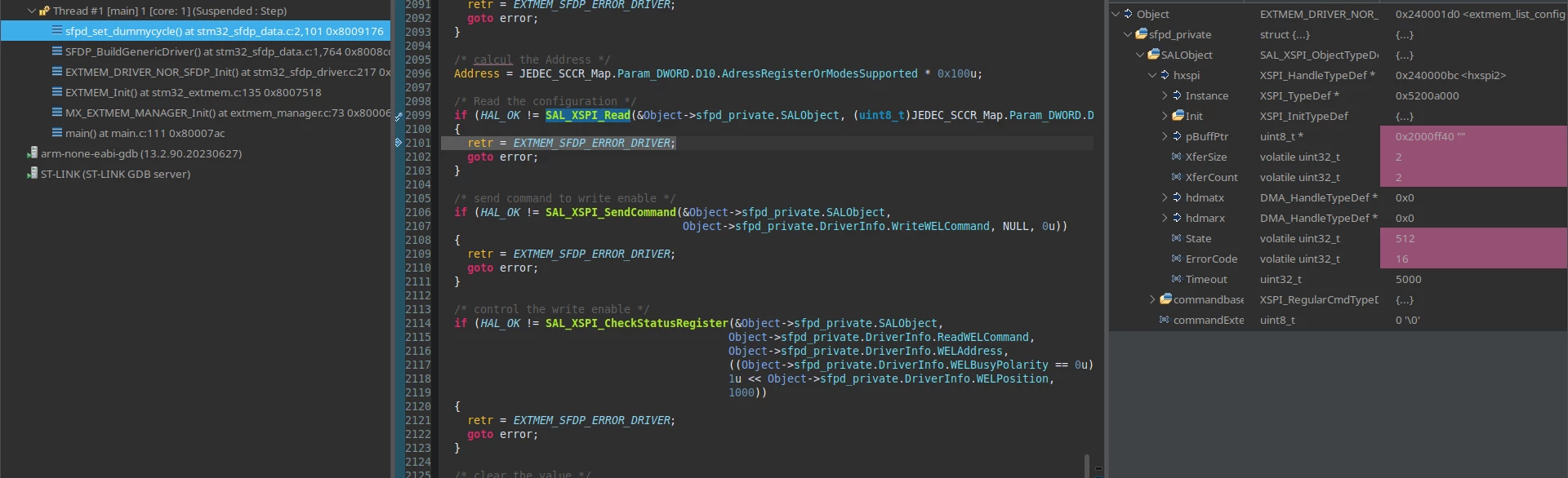

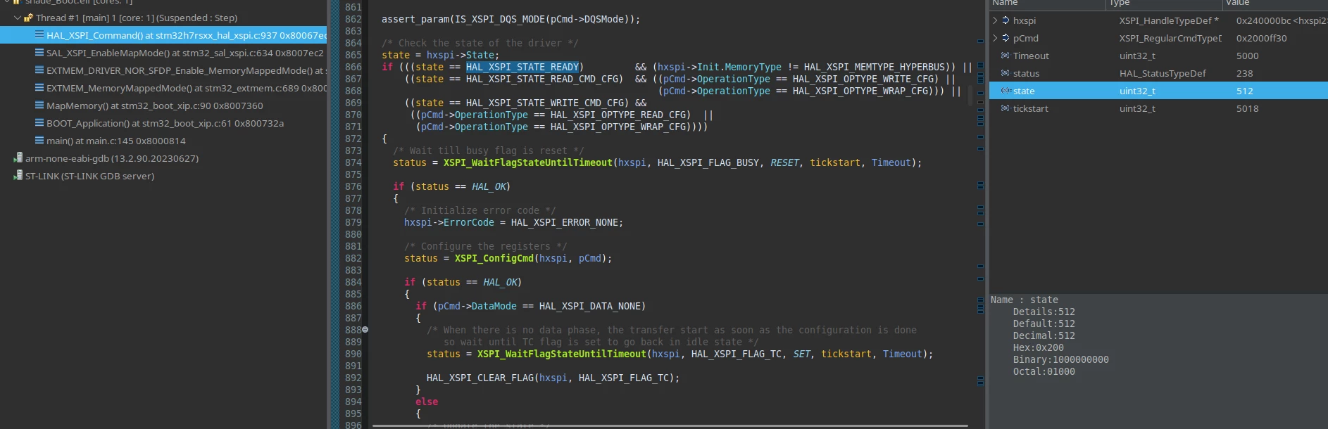

I must say that I have found the same problem with Template_XIP.
Debugging boot project, the function BOOT_Application() fails with BOOT_ERROR_MAPPEDMODEFAIL.
I have seen that this comes from HAL_XSPI_Command() making some checks, then setting hxspi->ErrorCode = HAL_XSPI_ERROR_INVALID_SEQUENCE and returning HAL_ERROR.
Additionally I have also tried to replace hxspi2.Init.MemorySize = HAL_XSPI_SIZE_32GB with HAL_XSPI_SIZE_256MB (256Mbits), but no luck.
bashiraAuthor
April 17, 2024
I can confirm this @Malvi2024
The function in question is:
HAL_StatusTypeDef HAL_XSPI_Command(XSPI_HandleTypeDef *hxspi, XSPI_RegularCmdTypeDef *const pCmd, uint32_t Timeout)
The state gets set to 512 somehow. I have not had time to debug this further, but I know that state is NOT valid after the init function MX_EXTMEM_MANAGER_Init()

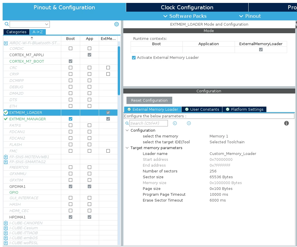

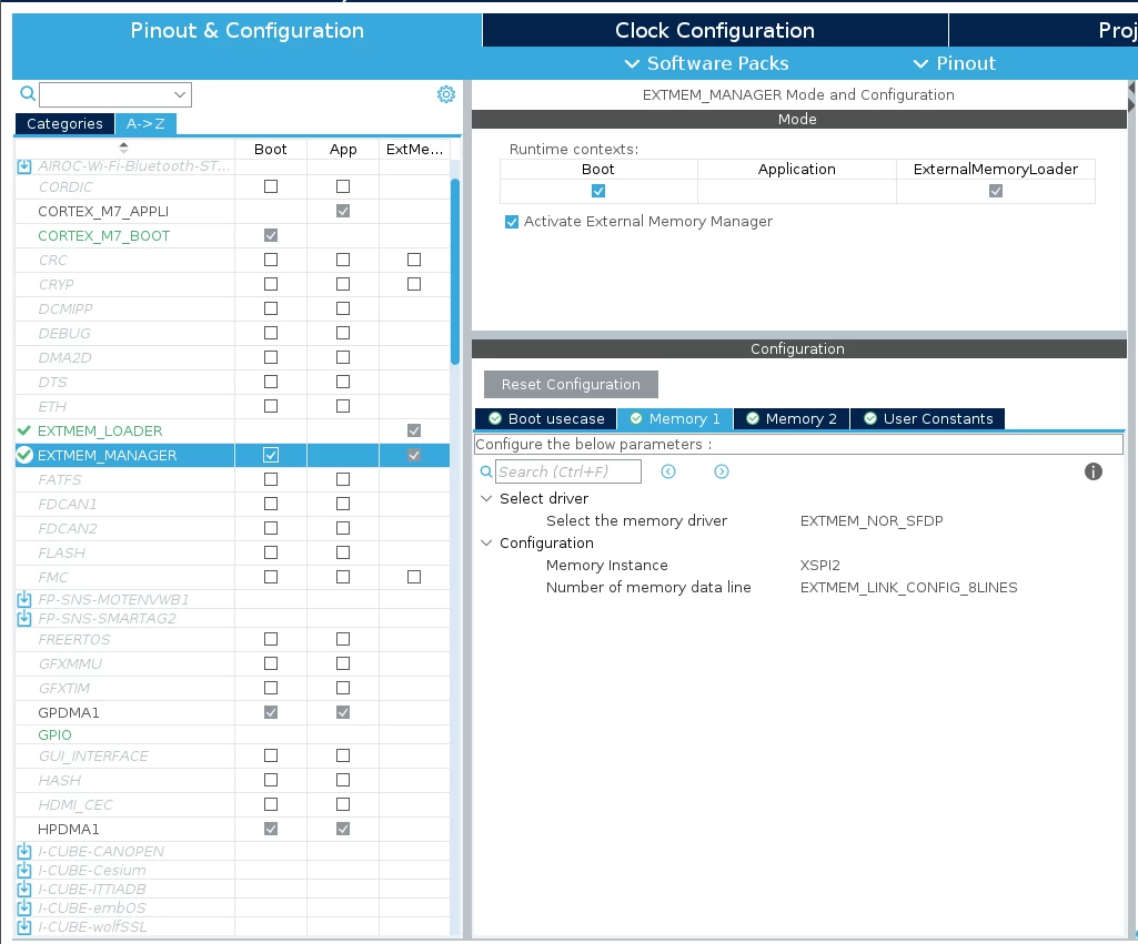

@KDJEM.1I just made a new project for the Nucleo-H7S3L8 board. Below is how everything is configured. I have not changed anything.
Thank you for the help.

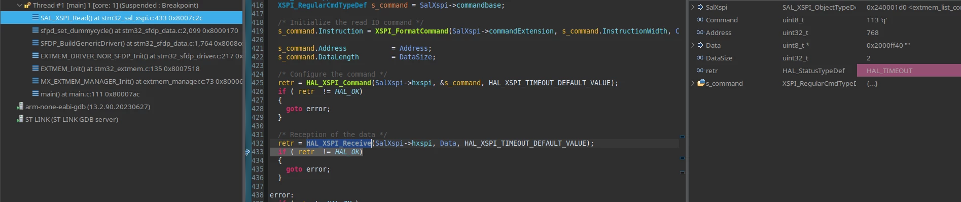

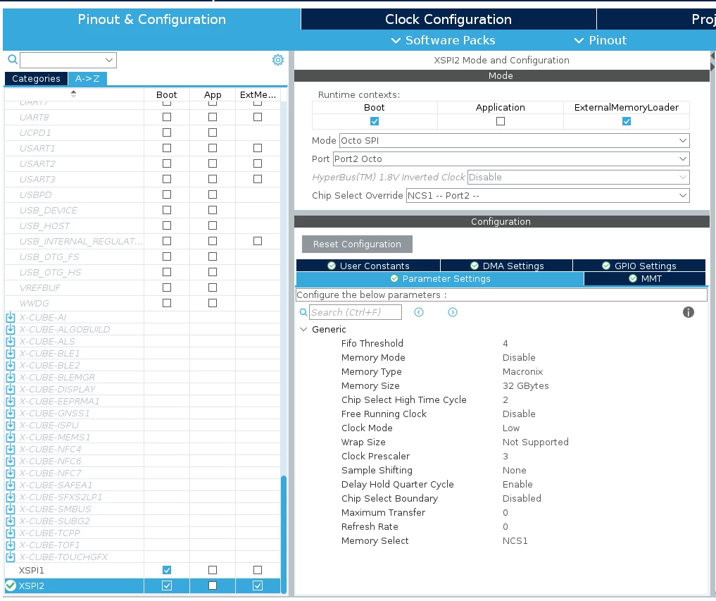

@Malvi2024I just had a little debugging session and I found out that the invalid state is set at this point:
inside the HAL_XSPI_Read() function there is a XSPI_Command() followed by XSPI_Recieve(). The recieve function seems to timeout.

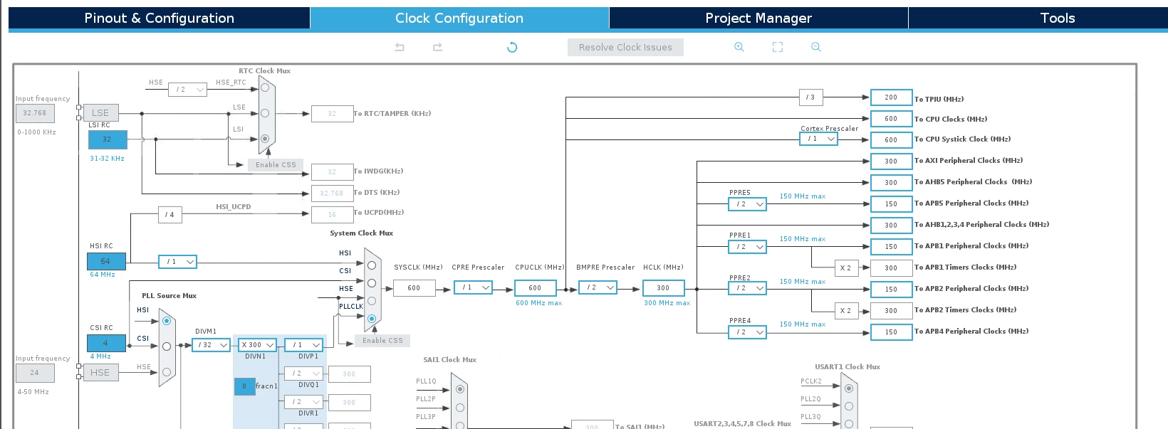

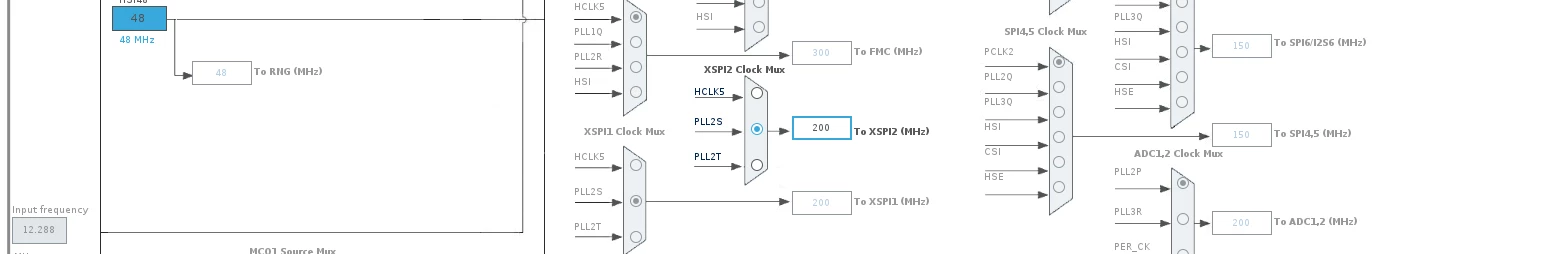

Here is my clock config.
Not sure, how to move forwards.
Thanks for the help guys.
