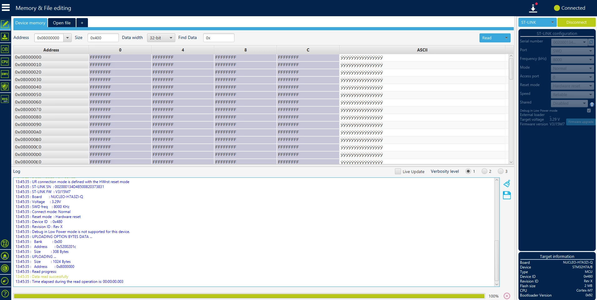

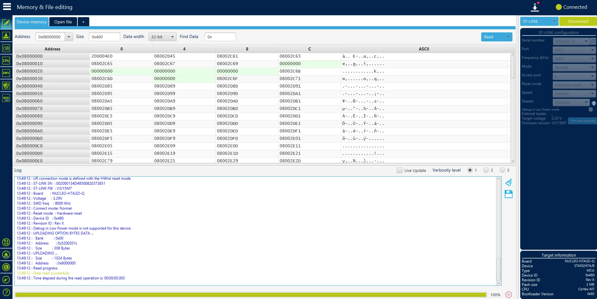

Feb 15, 2025 8:23 AM UTC
Hi AScha.3
I was able to connect to the HW using CubeProgrammer but not using the IAR workbench,I have tried flashing a hex file to the unit via CubeProgrammer and verified the flash contents everything looks fine, but i can't load or debug the code using the IAR Workbench.
AScha.3
Feb 15, 2025 8:40 AM UTC
perfect.
So we know: st-link working fine, target cpu is ok and responding.
If problem with IAR settings, try to find out, what you set wrong there or ask at IAR about this problem.
