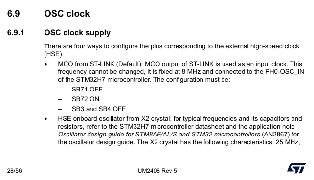

I have several NUCLEO-H755ZI-Q boards, the documentation says that the clock coming out from STLINK should be 25MHz but I meassured STLK_MCO and found an 8MHz signal... on SB72 to be more precise.
The sticker on the boards say
NUCLEO-H755ZI-Q
NUH755ZIQ$AT3
I was having issues when using HSE as a clock source, because I was configuring it to 25MHz as stated in the documentation and as it defaults to in CUBEMX... The issues went away when I set it to 8MHz.
Under the microscope X1 crystal shows 25.000.
Is there something to configure on STLINK to get the 25MHz?
Could the board be fake?

Becarefull, the boards having STLINK V3, can generate different frequencies on STLINK MCO according to the mode selected using the STLINK firmware upgrade tool:
NUCLEO-H755ZI has STLINK V3 onboard.
By default it's HSE/3 = 8.33MHz and not 8MHz:
And you can change this according to the menu in STLINK firmware upgrade tool.
Need to update the user manual of the board (internal ticket 190627).

This is what the documentation says on the NUCLEO-H755ZI-Q HSE input from ST-LINK: 8 MHz.

Thank you @Pavel A.  My mistake was assuming that the frequency of the STLINK crystal oscillator went directly to the MCU. This assumption was reinforced by the fact that when starting a project on CubeMX for this board, the frequency for HSE is set to 25MHz. However, this should be the setting for the unpopulated X2 crystal.

FYI: UM2408 / 7.9.1 OSC clock supply section has been updated:
"MCO from ST-LINK (default): The MCO output of ST-LINK is used as an input clock.
By default, it is fixed at 8 MHz and connected to the PF0/PH0-OSC_IN of the
STM32H7 series microcontroller. The frequency might be changed during an ST-LINK
firmware upgrade (refer to RN0093 for details)."
