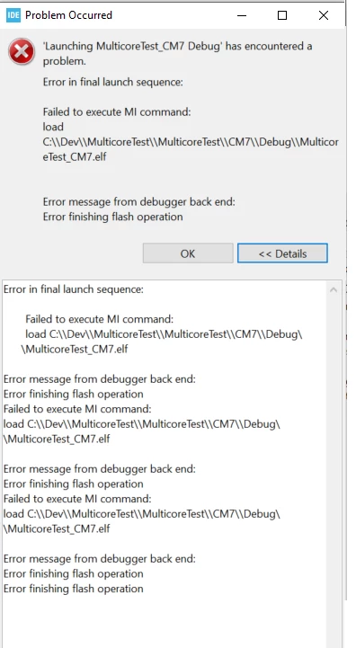

This fault has appeared very abruptly.  One hour ago I was working with the board just fine, programming via STM32CubeIDE. Then I swapped the board to a different USB port on my laptop, now it is not programmable.
When I hit the 'Run' button, it appears to be working, but then fails. The output is below:

As you can see, it looks as though it did program, but then failed to restart.  I know that it is not working because I am monitoring the UART for expected output but nothing is coming out.

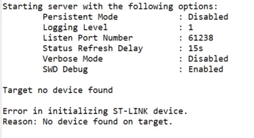

If I try to 'Run' again, I get
If I connect BT0 to VDD I can then connect to the board using STM32CubeProgrammer and do a full chip erase, but this just gets me back into the state where I started from.  If I try to program the device from within STM32CubeProgrammer, I get this:
Once again, it seems to be programming, and then failing on restart.

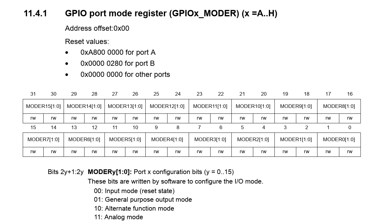

right, no "debug" setting needed, because chip begins after power up with the jtag pins enabled.
So as long as nobody writes any other setting to these pins...debug possible.
You can see this in rm , gpio settings at reset :
-> not all 00 , some on alternate function ->  for JTAG/SWD etc.
