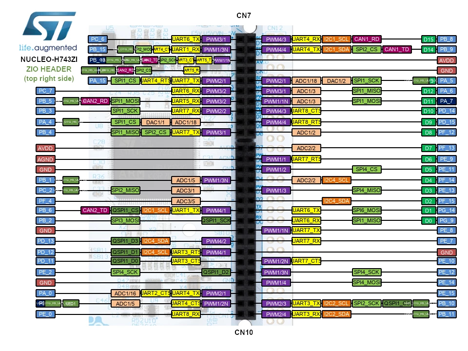

I think you misunderstood my question. What I would like to know, is which of the pins in CN7, CN10, CN8, CN9 are connected to which GPIO pin, like in this pinout for NUCLEO H743ZI.
(NUCLEO H743ZI has the same board as Nucleo-H755ZI-Q, but the pinout is different. I checked with a voltmeter.)

Ah, but your picture is not from an official source of STMicroelectronics.
However, you can find the GPIO assignment on the back of the NUCLEO board as well as on the front. If you prefer to look in the documentation, you can find the pin assignment of the connectors in the UM2408 or the schematics, for example.
