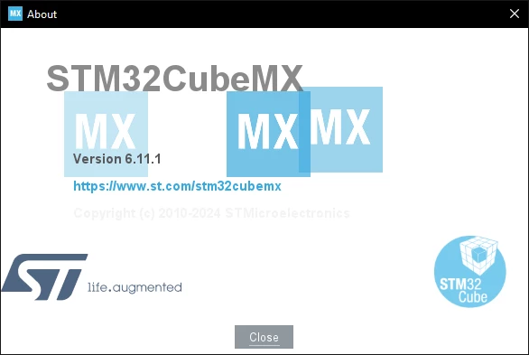

Hi Imen, thanks for the quick repsonse!
I forgot to mention I'm using STM32CubeMX v6.11.1.
Somehow it's not in my STM32CubeMX v6.11.1.

Hi @Jack3 ,
It's strange! Please try delete old CubeMX versions and keep only the latest one to make sure that you are using properly the last release (v6.11.1).
Otherwise, please share your ioc file to check this case.

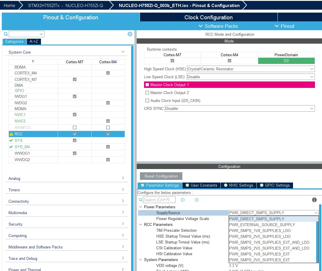

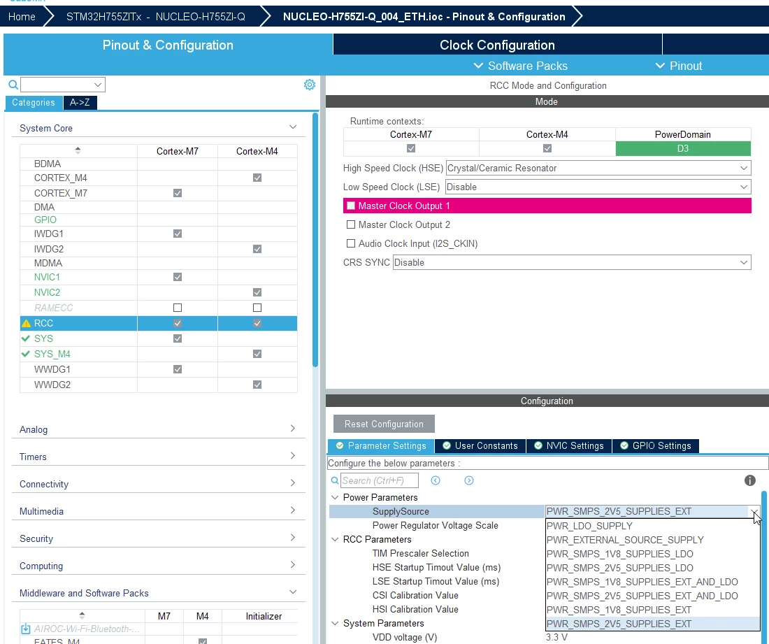

Hi Imen,
thnak you very much, I deleted the old CubeMX versions, and use the latest version.
I now attached the ioc file.

Hi @Jack3 ,
This is a normal behavior, as you are using a core frequency above 400 MHz, which requires the use of the LDO and pushes "PWR_DIRECT_SMPS_SUPPLY" option disappear.
You can refer to the STM32H755 datasheet and check the Table 24. Supply voltage and maximum frequency configuration:
So, reduce the core frequency to 400 MHz, then keep me informed about your update.
