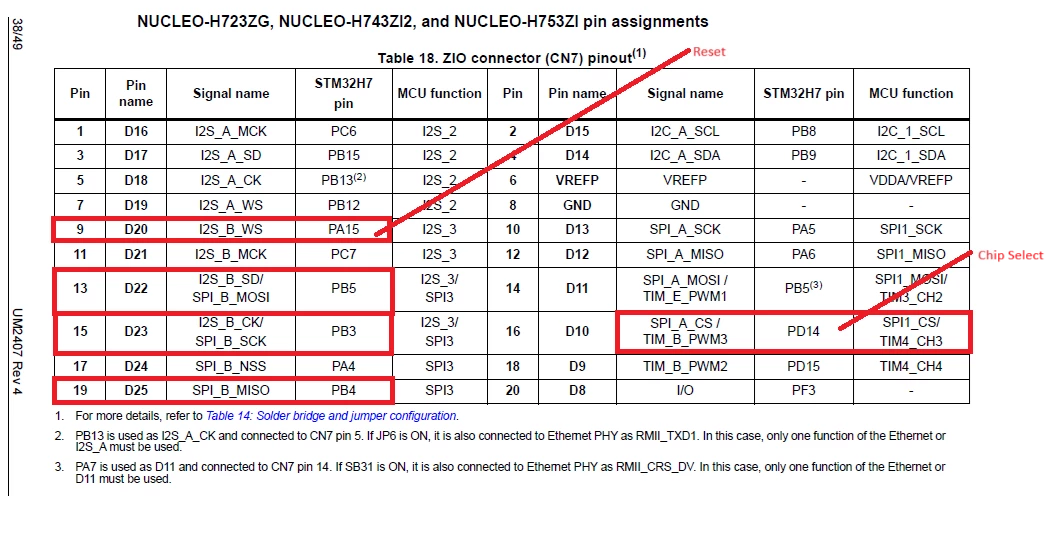

>>Schematic?
Here is how I am connecting wires in both cases. I don't need to change the wiring or schematic. When uploading through arduino my adc works fine. In both cases I am using SPI3

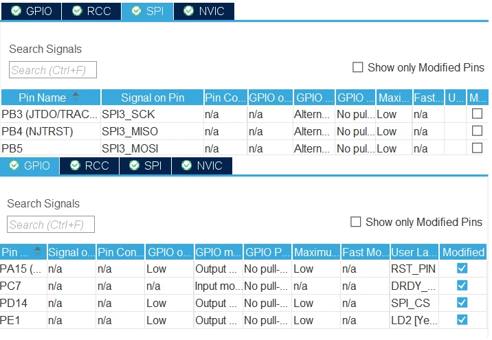

Below is the CubeIDE pin config
What Arduino were you using?
I am using Arduino IDE 2.3.4 and CubeIDe is Version: 1.18.0 Build: 24413_20250227_1633 (UTC).
