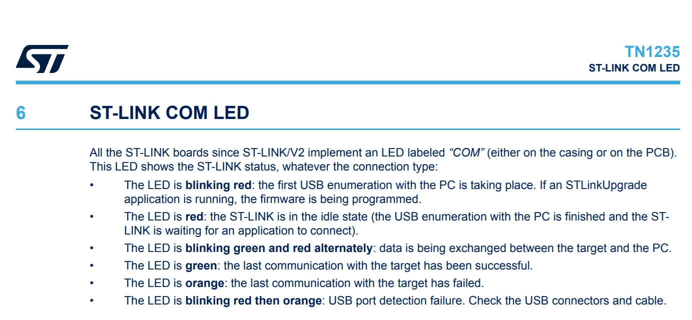

I am a beginner at stm32 Nucleo board, when I connect the board and the Lap, LD5 turns green but LD4 turns to green/red blinking, which means the voltage is correct but the MCU has no response or connection error. Could you please help with that?

Green/red blinking by itself does not mean trouble. It just indicates activity. Where do you see "no response" or any error? CubeIDE or Programmer?

I used stm32programmer to connect the board, and the LD4 keep blinking red/green which means lap and board are unable to exchange data. And on IDE it shows "No st-link detected". Sorry if I misunderstood anything, I'm just a beginner.

@DeMar So the situation is that CubeProgrammer sees the ST-Link - but the IDE does not. The board is Nucleo, so "fake ST-Links" are excluded. May be, a bad cable or a driver issue caused by 3rd party software.

About LD4 on Nucleo-H753ZI, it's called "ST-LINK COM LED". you may find details information about this LED function in TN1235.
Attached below also a capture of key information. thanks!
