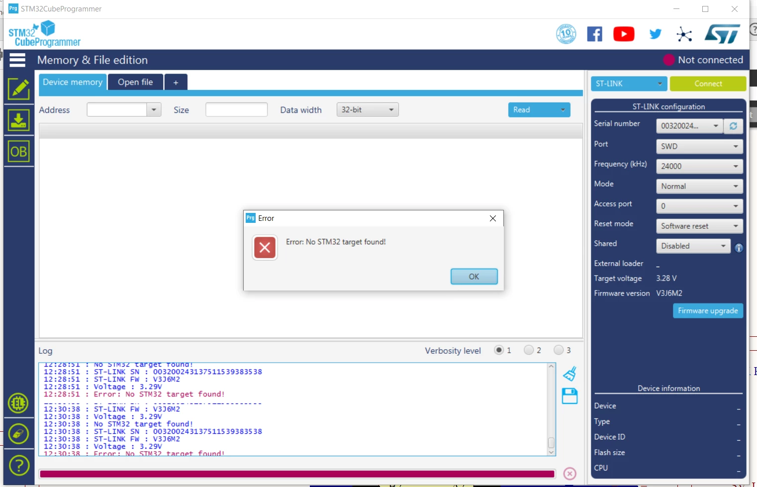

September 17, 2020
Today i connected the custom board with ST-link/V3. Error "STM32 target not found error" message received.
Measured Voltages: VDD_MCU=3.3V, VDD_LDO=3.3V, V_core=1.005V.
SWD Clk and SWD_IO signal measured on CRO and able to see clock and data. Any further suggestion what could go wrong?

image of error for reference

When going off-board, a speed of 24 MHz may be detrimental. Try with lower speed.

After removing level translator that is used in nucleo board (in swdio and swo lines) and keeping the on-board MCU supply jumpers off, Now we are able to connect the STM32H745XI custom board in boot mode and erase flash successfully. However, we are not able to load firmware or debug in normal boot mode. Any suggestion on this.
