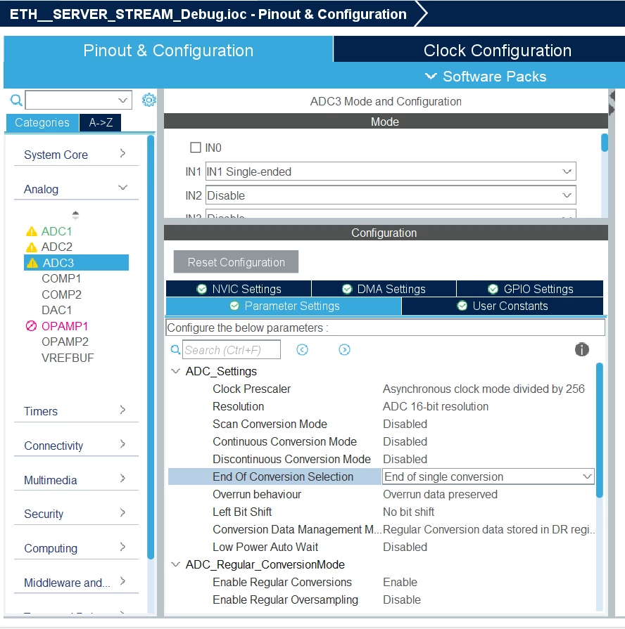

I am currently working on a project involving transferring data acquired with an ADC through ethernet.
Im am using the STM32H743 MCU.
I have been building small projects using LWIP, and was able to connect to the board, ping and transmit some array data through Ethernet. However, once i enable any of the ADCs, I cannot connect to the board for some reason. There is no error during debug or anything, but I am no longer able to communicate with the board.
I have had similar problems in the past with interrupts interacting weirdly with LWIP, I know this middleware is know for having some flaws.
I wanted to know if anyone has had similar issue with LWIP and ADC, and even better if a solution is known.
I thank you in advance.

What is your ADC setup? Sounds like the system might be getting swamped with interrupts once ADC gets turned on. Lower sample rate.

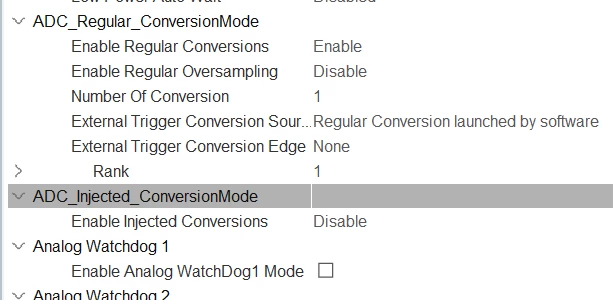

It is a regular conversion triggered by software, I should not even be launching conversions at this point.
I disabled ADC interrupts for the moment.
January 4, 2024
If it isn't running, what does "enabling" mean here specifically then?
There's no fundamental issue with running LWIP/Ethernet and ADC simultaneously, so the solution will likely be specific to your code/board/setup.

"Enabled" means i simply enabled the ADC in the CubeIDE configuration panel. I uploaded a picture of my config below so you can see.
I indeed suspect there is something wrong with my setup but cannot pinpoint it.
I managed to make the ADC module work without problem in the past, so my best guess is that I messed up something with the LWIP.
