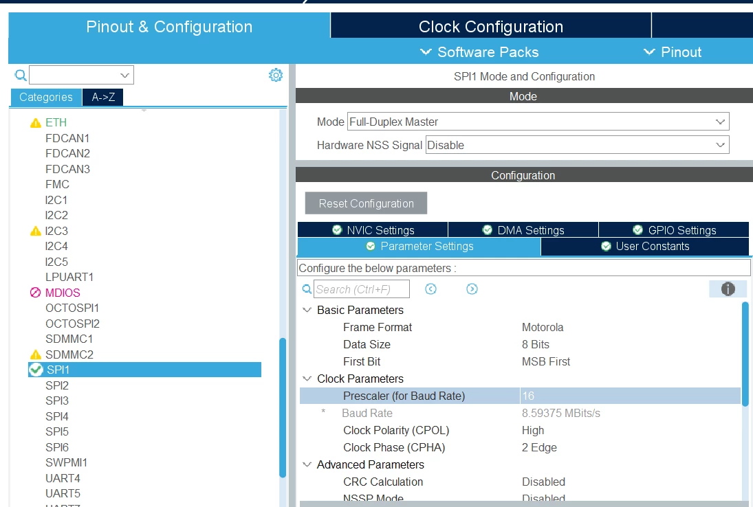

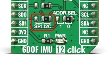

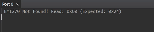

I'm new to embedded programming, and I'm currently working on establishing a basic SPI connection between an STM32 microcontroller and the BMI270 IMU sensor by Mikroe. My goal is to read the Chip ID (CHIP_ID register at 0x00) and get a response of 0x24, which confirms proper communication,Currently, I'm not getting the expected 0x24 and instead receiving either 0x00 or 0xFF when reading the Chip ID. Any guidance on what might be wrong or missing in my setup would be greatly appreciated, please see code work flow .
Code Execution:
- Step 1: Perform a dummy SPI read to switch BMI270 from I2C to SPI following the documentation on [1] page 19 (Quick Start Guide ) and 139 (6.3. Primary Interface Digital Protocol Selection)
- Step 2: Send CHIP_ID read command and receive the response.
- Step 3: Validate if received 0x24 (BMI270 detected) or print an error message.
Reference:
[1] - https://download.mikroe.com/documents/datasheets/bst-bmi270-ds000-2_datasheet.pdf
- Full-duplex Master
- Frame Format: Motorola
- First Bit: MSB Frame format
- Prescaler: 16
- BaudRate is 8.59 MBits/s
- CPHOL: High
- CPHA: 2 Edge

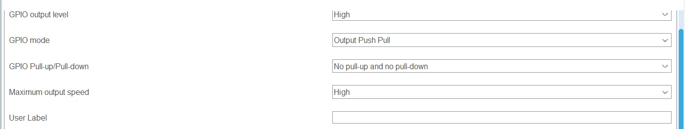

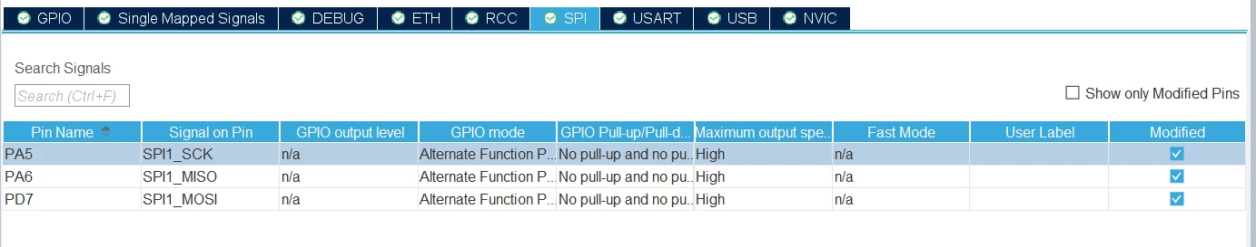

SPI PINS:
- PA5 (SPI1_SCK): Alternate Function Push-Pull, High Output Level, No pull-up/pull-down, High Speed.
- PA6 (SPI1_MISO): Alternate Function Push-Pull, High Output Level, No pull-up/pull-down, High Speed.
- PD7 (SPI1_MOSI): Alternate Function Push-Pull, High Output Level, No pull-up/pull-down, High Speed.
- PB12 (SPI1_CS): Output Push-Pull, High Output Level, No pull-up/pull-down, High Speed.

Debug Mode Ouput
