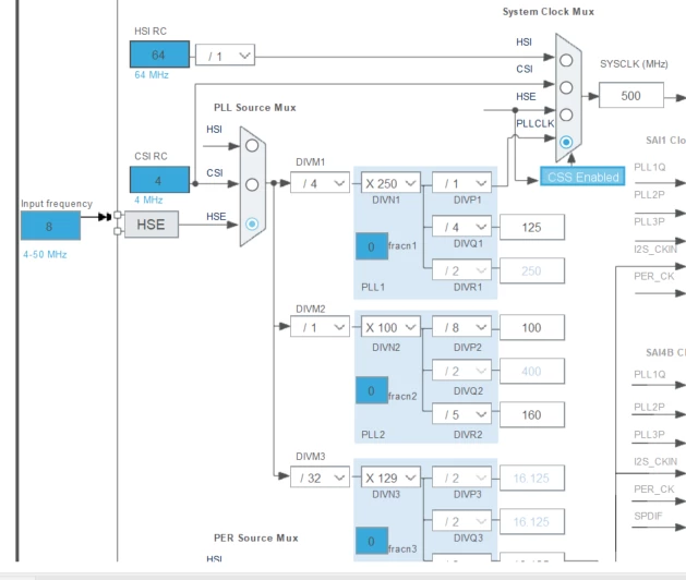

I'm trying to sample a sine wave between 400 and 500 kHz with the Nucleo H723ZG. I'm using the 16 bit adc 1 with following configuration:
  • sampling rate: 2 MSps
  • T_sampling: 16.5 clock cycles
  • f_adc: 50 MHz (from PLL2P: 100 MHz)
  • DMA circular mode
  • continuous conversion mode
  • adc trigger: regular conversion launched by software
I'm trying to calculate the correct frequency of the signal. The calculated frequency fluctuates between +-500Hz, which is not accurate enough.
The code to calculate the frequency has been tested with pre-generated values with a given frequency and works fine with an accuracy of +- 1Hz.
I already checked the reference voltage VREF, which is fine, and removed L1 (as described in https://community.st.com/t5/stm32-mcus-products/fluctuations-in-adc-value-of-stm32h743-mcu/m-p/331501#M79889).
There seems to be a problem with the sampling / sampling rate.
Any solutions will be highly appreciated .

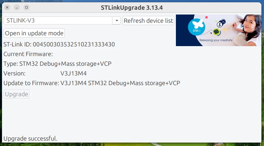

Using 8 MHz from ST_Link has no sense, since ST-Link is running on it's own HCI in default config. You need to reprogram ST-Link to run on 25 MHz crystal clock , than divide by 3 - so strange 8.33 MHz output. My understanding that ST use 25 to comply with Ethernet 50 MHz requirements.
  It's not very convenient to re-map all frequencies, I usually set PLL to 950 MHz for my H743/753, but it's the easiest way to have clean primary clock on nucleo-H7.
