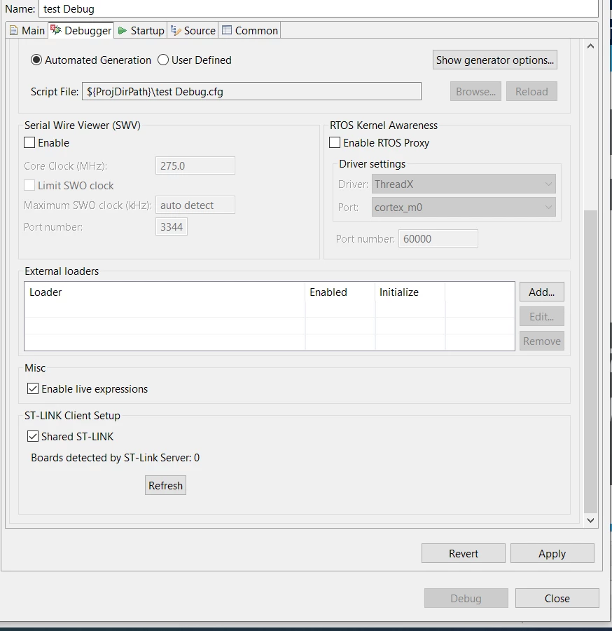

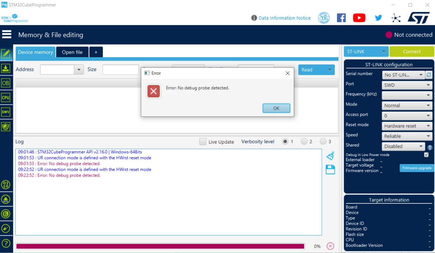

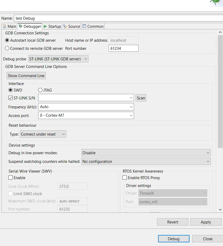

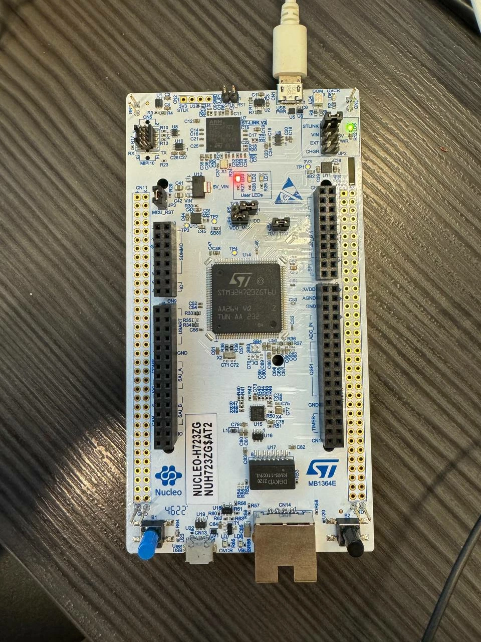

I have recently purchase a Nucleo-H7 board which uses the STM32H723ZG. I have tried to connect the board to my pc in order to flash it and it does not show up in either the CubeIDE or the Cube programmer. I am using windows 10 and all the drivers are updated. I have also tried the workaround I found here about manually copying libusb-1.0.dll to the stlink_server folder. I have installed the latest version of the Cube IDE, the Cube Programmer and all of the drivers needed. I have also uninstalled and installed both the CubeIDE and the prorammer, but still neither of them can detect the board.
I included screetshots of the debugging config and the programmer. also from the board. please let me know if I'm doing something wrong.

>>I am pretty sure the cable I am using right now is data cable since I have used it with arduino before.
A cable adequate for USB FS (12 Mbps) might not be sufficient for USB HS (480 Mbps), the ST-LINK/V3 boards use the latter. Use high quality cables suitable for purpose, they are frequently marked as such. Tend to be fatter, with twisted pair wiring and shielding.

Make sure Windows is responding to the cable being plugged in and out and you can see the device in Device Manager. Unless seen there it's not going to be usable elsewhere.
Try a different cable. Charging Cables won't work if there's no data wires in them. Try other USB ports, avoid hubs and docking stations.

Thanks for your reply. I have tried different cables and usb ports. disconnected my hub as well but no change.

Also it does in fact not show up in my device manager. so could that be a driver issue?

you should use a data and not a charging cable. Also, try throw different USB ports on your PC.

As @Tesla DeLorean said, check Device Manager - if it's not appearing there, then nothing else is going to see it.

That thread also illustrates how Hubs/Docking Stations can cause problems ...
