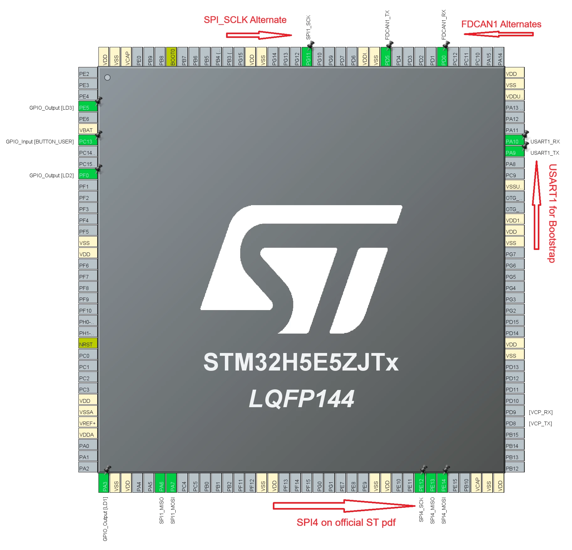

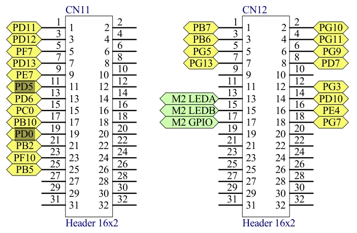

Here is another example of how I have used 5e5_main_v2.pdf to help select pins.
By using 5e5_main_v2.pdf I can quickly search through a port to see where it is on NUCLEO PCB connectors and see if it is committed, here is an example showing highlighted ports I chose for FDCAN1 Tx and Rx:-
I selected these alternates using ST Core MX on the pinout view:-
Also using the official NUCLEO-H5E5ZJ PCB schematic I found SPI4 already labelled and brought out to CN5 and CN10 as is already on the PCB and the official NUCLEO-H5E5ZJ PCB schematic.
Then I found pins for SPI1 using MX and 5e5_main_v2.pdf again checking they were free. I found that PA5 for SPI1_SCK was not free on the PCB, (its used for Ethernet PHY) so selected an alternate PG11 as SPI1_SCK.
And the great thing is that ST Core MX writes the configuration code automatically! Very impressive, well done ST!
