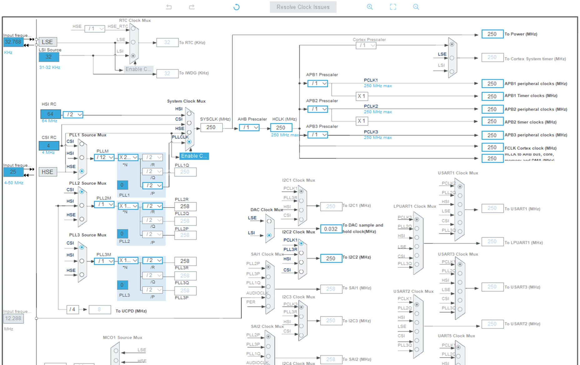

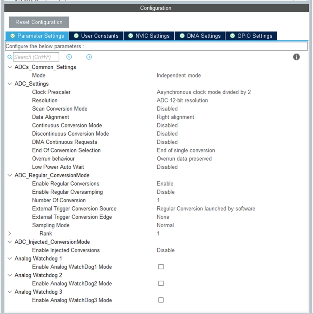

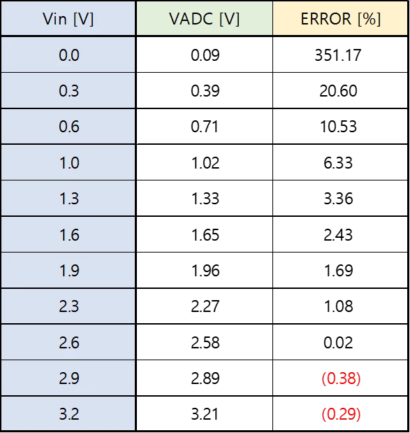

I want to use my ADC of NUCLEO-H563ZI, but there is a problem with my ADC. ADC output does not match to input voltage. Test results are as fallows.

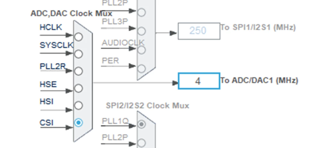

I am using ADC2 IN1, IN2, IN3, IN5, IN6, all singled ended. And I am using 25MHz HSE OSC of NUCLEO-H563ZI instead of ST-LINK 8MHz output, and disabled ICACHE.
Is there a problem with my ADC/Clock configuration settings?

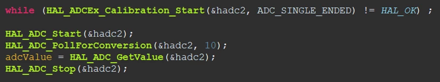

The ADC needs to be calibrated on every startup before it is used. Are you doing that?
Sampling time generally has the largest impact. Use the longest sampling time for the highest accuracy on a DC signal.

I am using ADC as below, to calibration my ADC before ADC Start.
Is this a normal way to use it? It seems that HAL_ADCEx_Calibration_Start() doesn't work.
Jul 31, 2024 1:25 PM UTC
Probably a test setup issue. How are you applying these voltages exactly? What is your ADC sampling time? If you directly tie an ADC input pin to GND on the board, what value do you get?
