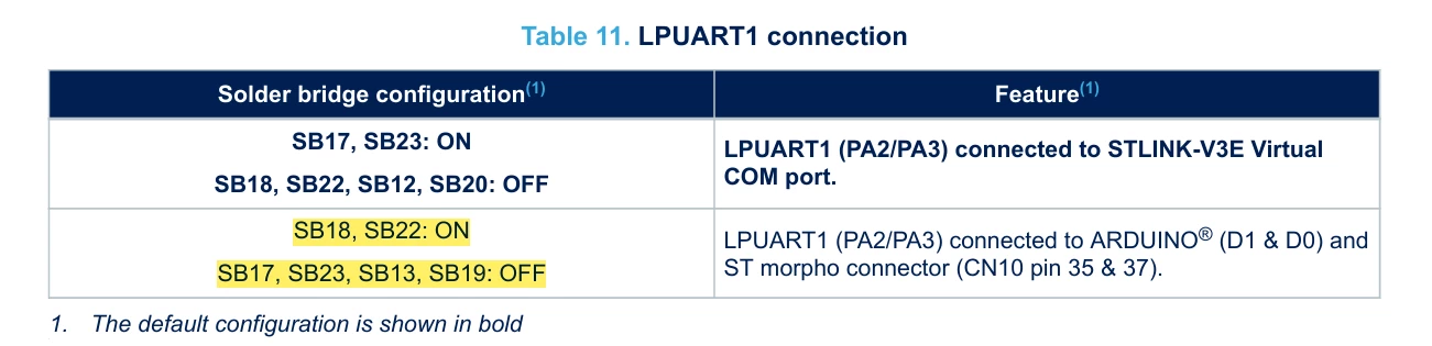

I am using Nucleo-G491RE. I am debugging through the built-in ST-Link using STM32CubeIDE 1.18.1. My design uses opamp1 in standalone mode, which assigns OPAMP1_VOUT to PA2 and OPAMP1_VINM to PA3. What configuration of solder bridges will bring these opamp signals to the Arduino or Morpho connectors?  I have studied the user manual (MB1367) section 6.7, but it is not clear to me.

SB18/SB22 on
SB13/SB17/SB19/SB23 off
PA2/PA3 are then brought to the headers instead of the default PC4/PC5.

It might be clearer to look at the schematics?
