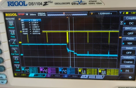

TDKBest answer
Aug 26, 2025 11:59 PM UTC
But unplugging the USB doesn't disconnect the device from the STM32. The RX pin is still connected to whatever is on the adapter board, along with TX and GND.
As its power starts to drop, it is still trying to drive that pin but VDD isn't 3.3 V anymore. That's what you're seeing. Eventually, the chip powers off and the pin goes high impedance.

pasuzwAuthor
Aug 22, 2025 5:56 AM UTC
Blue is Rx and Yello is Tx.   There seems no pull up on Rx, so it drops when UART cable is disconnected.
Karl Yamashita
Principal
Aug 22, 2025 10:08 PM UTC
UART uses push-pull on the TX pins. So yeah, if you disconnect the USB to the FTDI, it can't pull the Rx pin to high.

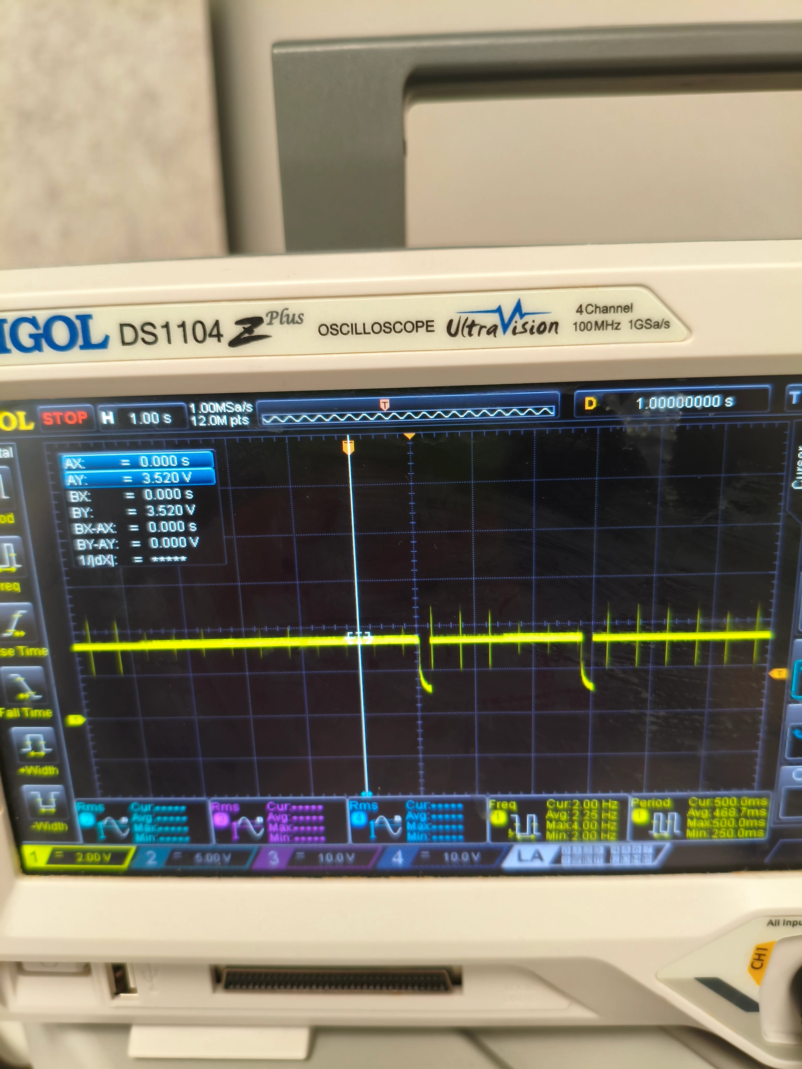

pasuzwAuthor
Aug 26, 2025 2:03 AM UTC
Hi Mike
I tried to use the internal pull up and got below behaviour. It seems still a voltage drop for a short period of time when I disconnect uart cable.  Is it normal ?   And I can see vertical noise that is synchronized with Tx timing,  which is probably due to coupling ?
Mike_ST
Aug 26, 2025 8:43 AM UTC
>> I tried to use the internal pull up and got below behavior. It seems still a voltage drop for a short period of time when I disconnect UART cable. Is it normal ?
Can't tell.
I have never analyzed plug/unplug events on a serial line.
I'm not sure what I'm seeing on the scope, what kind of event it is, at what time stamp, and where the probe is connected.
Is it a RX+GND disconnection, or is it just the RX wire ?
Probably.
pasuzwAuthor
Aug 26, 2025 10:38 PM UTC
-> I disconnect the usb port of FTDI C232 HD cable on the computer side.
Aug 26, 2025 11:32 AM UTC
Something isn't right here. If you disconnect RX, and the internal pullup is enabled, the level will not drop.

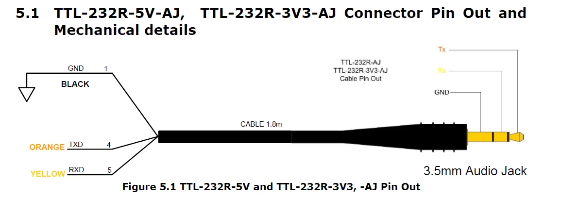

What connector does the USB-to-UART cable have on the STM32 end?  Is it one with the tip.ring/sleeve audio style connector (FTDI TTL-232R or TTL-234X cables)?  If so, as you unplug that connector it can temporarily short the RX to GND.
EDIT: Like this:
pasuzwAuthor
Aug 26, 2025 10:41 PM UTC
I am using FTDI C232HD, and it has 3 seperate wires to connect to STM32 pins.   I disconnect UART by unplug the USB connecter on the computer side.
