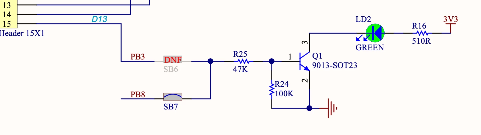

good morning, I am wondering what the DNF means in my datasheet:
does it mean there is no connection between pb3 and the LED? then i am wondering if i can use PB3 for other instances, and i am also wondering why there is this DNF instead of just not connecting PB3 and the LED

> can i still use PB3 as GPIO input from the nucleo header for another use?
In theory yes.
UM2397 states:
LD2 USER
This green LED is connected to the following STM32G4 I/O:
• PB8, if the configuration is SB7 ON, and SB6 OFF (default configuration)
• PB3, if the configuration is SB7 OFF, and SB6 ON
But according to the schematic PB3 is also connected to T_SWO via SB4, so it is connected to the onboard ST-Link.
So if you want to use PB3 as GPIO it will be necessary to open SB4, and you will lose SWO.

DNF = "do not fit"
Keep it open usually (or think about before closing)...
And yes, you can use PB3 for any other purpose, since it is not connected to LD2.

so it means that the solder bridge do not fit?
thank you for the quick awnser
Exactly.
It means that it is not fitted during manufacturing - but left there as an option for the user fit, if required.
It is pretty common throughout the industry - not specific to ST or STM32
Sometimes you will see similar terms like DNP = Do Not Place, etc ...
