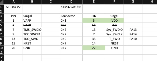

I would like to program the Nucleo board via the SWD interface or via ST Morpho connections via a ST-Link V2 (pod) programmer, is this possible? I am trying to emulate the programming that will occur in our factory without the use of the USB ST-LINK interface that will not be present on our PCBA. I have tried several methods of connecting the ST-Link V2 to the SWD interface, removed the ST-Link jumpers, applied external power and this did not work. I have also tried directly to the MCU via SWSCLK (PA14), SWDIO (PA13) , DGN, NRST and this did not work either. Any help in point out what I am missing would be greatly appreciated.

This is the output from the programmer CLI
ST-LINK SN : 34FF68063048553739201643
ST-LINK FW : V2J29S7
Board    : --
Voltage   : 4.20V
Error: No STM32 target found!
libusb: error [submit_bulk_transfer] bulk transfer failed (dir = In): pipe is stalled (code = 0xe000404f)

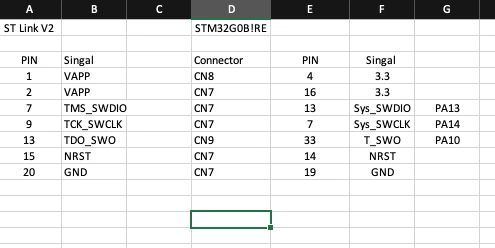

I have the device wired up as follows:

Well take a spare nucleo, break off the STLink Part, and use Morpho connector to make sure all the required ground, SWDIO, SWCLK, Reset are connected properly. You will need to provide power to the target separately to be in your production situation. (power source jumpers on the target STM32 side).

Thank you for the information. I have 5V PWR provided to the MCU via the Morpho connector as well as the jumper in the correct position (CHG) to power up the board. The ST Link on the STLINK portion is disabled via no jumpers on CN4 (ST-Link). With external 5V connected, the ST-Link Programmer connected the MCU is executing my code, however when I try to program the MCU I get the following:

Tesla DeLorean
Guru
January 30, 2023
The pin 1 of the ST-LINK should not be 5V, but rather the voltage of the Target, so either 3.3 or 3V typically.
