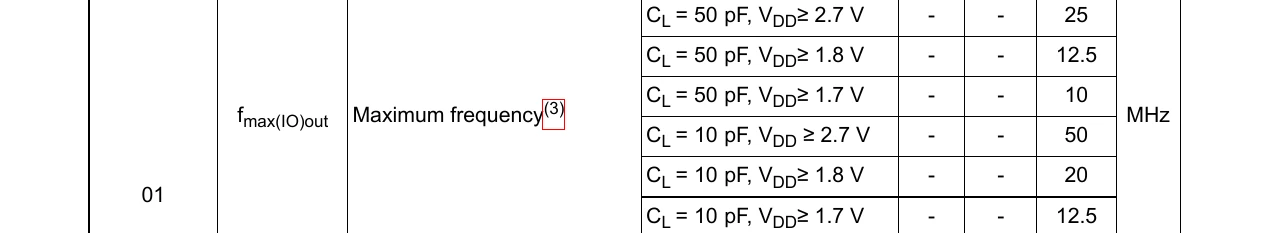

So for 15MHz look at ds , to check the appropriate pin speed:
If pin at 3v3 and low cap loading, medium/low speed would match, speed 01 .
So set this as pin speed for all spi pins (clk, data...) and check again.

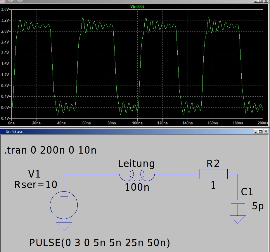

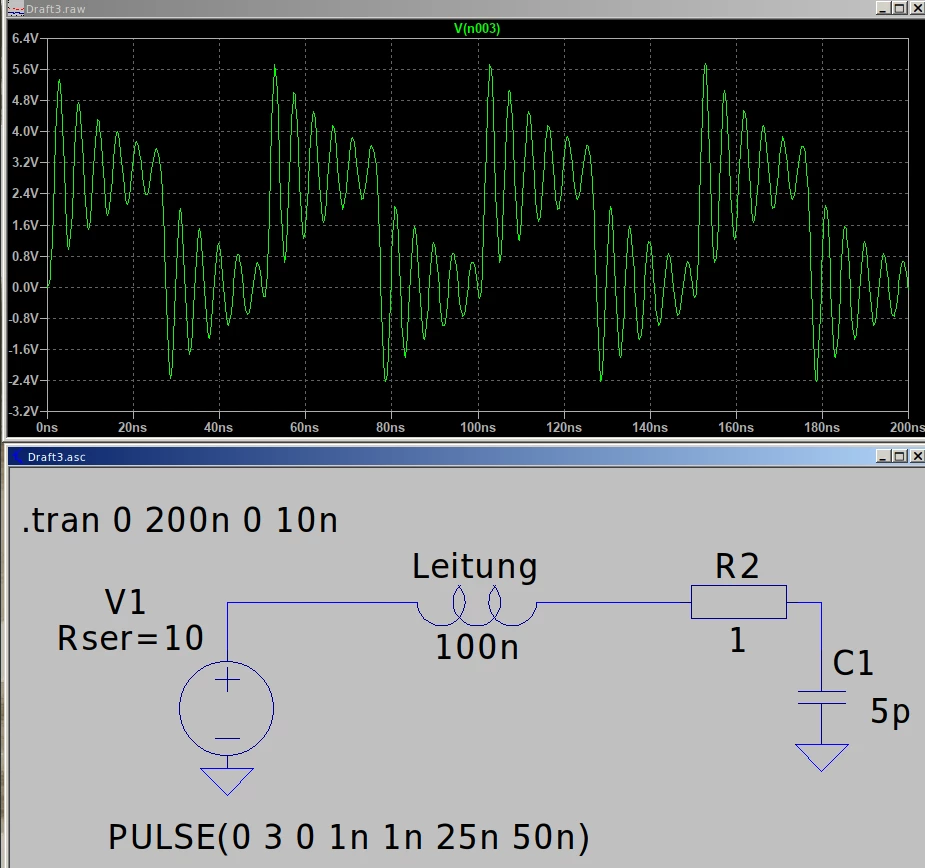

And here some pics to show, what comes out - just from physics :
20MHz 3V square , 1ns rise/fall , just looked with a scope probe (5pF load ! )
same at 5ns rise/fall time :

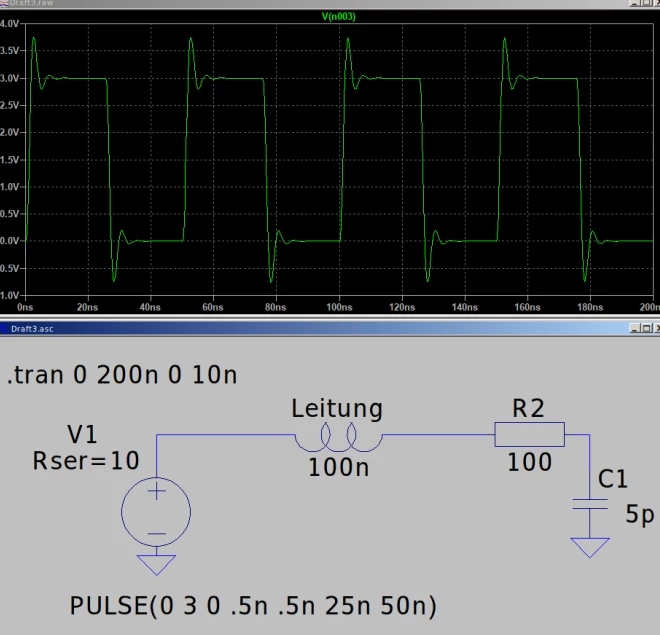

And with a 100 ohm resistor, to reduce ringing, also 1ns rise:
So if your wires > 30mm or so, add series damping resistors on all signal lines.
