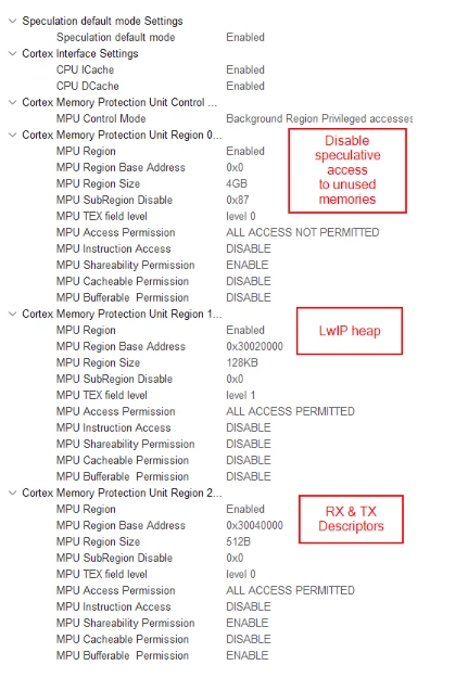

I am using Nucleo F746 eval board. I configured ethernet and lwip. But I can't get ping. "Reply from 169.254.255.144: Destination host unreachable." I get feedback like: My ETH and Lwip configurations are below. Can you help with this issue?

KDJEM.1
September 28, 2023
Hello @HS_it ,
The STM32F746xx devices are based on the high-performance ARM®Cortex®-M7, for that it is recommended to configure cortex-M7:
  • Enable ICache and DCache.
  • Enable memory protection unit (MPU) in “Background Region Privileged access only + MPU Disabled ...” mode. Configure regions according to the picture below:
Could you please check the MPU configuration?

RMasi.19
November 24, 2023
I use F746_Discovery, i follow your recomendation about MPU and LDCache, and the configuration before about LwIP. In the main.c i have added:
extern struct netif gnetif;
while(1)
{ ethernetif_input(&gnetif);
sys_check_timeouts();
In the pc i made ping 192.168.000.123 but no have answer of the F746, some can lack here ?
