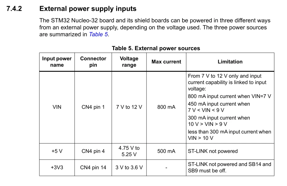

> When my F411RE board is powered with 5V, ...
What do you mean here exactly ?
Through the USB / ST-Link, or a 5V header pin ?
Check the user manual what power supply methods are allowed and what conditions apply.
Here a section from a Nucleo-32 manual of mine :
> Why doesn't it start?
How do you know it's 'started' or 'not started' ?
