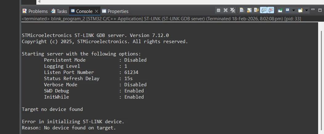

Nucleo-f401re: No device found on target
Screenshot 2026-02-18 200213.pngUnable to run the program in the MCU. When I try to execute the program in my Nucleof401re board, The IDE says it is not able to detect the board. I'm literally struck here just to blink an led. I kindly appreciate any possible solutions. But do explain it in simple terms as I'm new to this kind of stuffs.

Can you connect with STM32CubeProgrammer?
Ensure the USB cable is not power-only. The LED will be solid red when the USB connects. If it's blinking between red and off, there is no connection.

Can you please check if these steps are established:
  • Check if USER_LED3 is turned on.
  • Check if USER_LD1 is green.
  • Attempt to connect to the board using STM32CubeProgrammer. If the connection is successful, what's the detected voltage.
  • Check that CN2 is selected.
You can check section 6.1 from the STM32 Nucleo-64 boards (MB1136) - User manual
