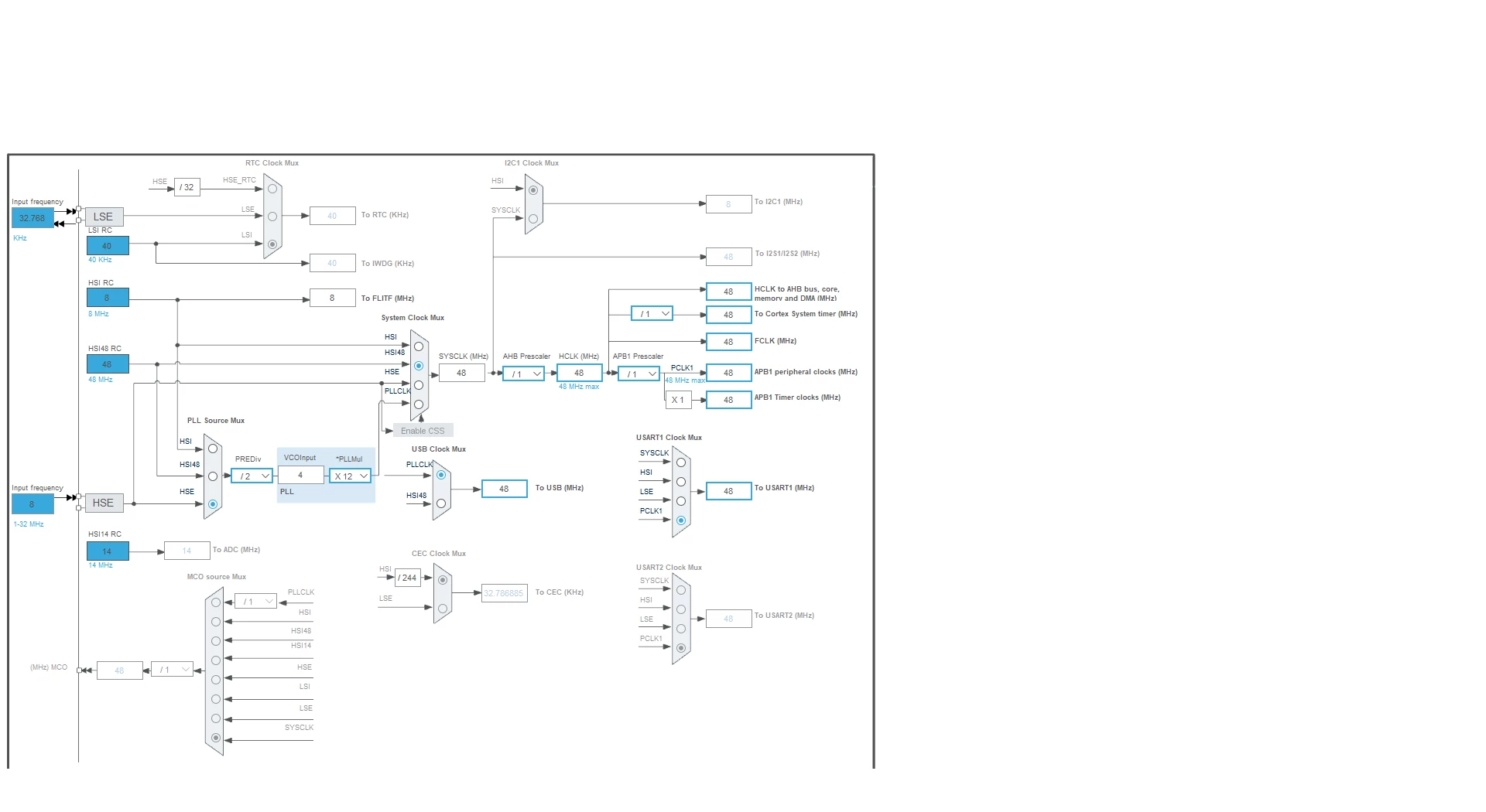

I am having trouble getting the USB peripheral recognized by the PC device manager.  In Cube I have the USB FS device checked, and the USB_DEVICE middleware set to virtual COM port.  Everything else is set to default.
The USB clock is set to 48MHz coming from the HSI48 source.
When the peripheral is connected to a PC (through a HUB) the device manager refreshes but the VCOM port does not show.
Thanks for the help.
Brian

HSI as clk for USB might not be good enough.
Use HSE / crystal as source.
bwisselAuthor
April 15, 2024
I changed from HSI48 to the PLLCLK at 48MHz without success.  Here is the clock mapping for reference.
Thanks

I did notice that on the nucleo board I am using X3 is not installed, this looks like the source for the HSE clock.  That would explain why when I switch from HSI to HSE it still didn't work.
