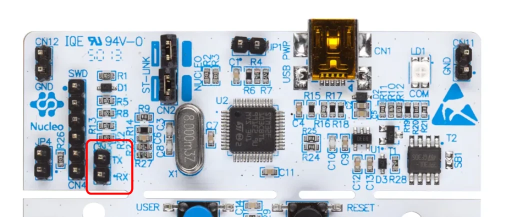

Your NUCLEO-F072RB board has a jumper - CN3 - on the ST-Link section where you can probe:

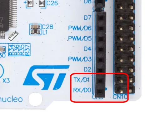

Also probe on the Arduino CN9 header:
(and/or CN10).
Do you see activity on TX when the STM32 is transmitting ?
Do you see activity on RX when the terminal is transmitting ?
PS:
If you disable the TX & RX pins on the STM32F072 Target, you can put a jumper on CN3 and do a loop-back test from the terminal.

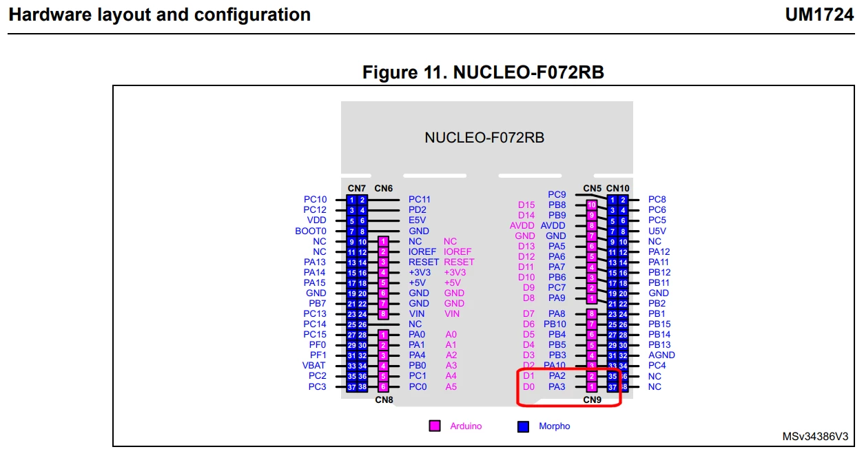

Nov 3, 2025 10:34 AM UTC
@Andrew Neil wrote:
(and/or CN10)
Note that the Arduino D1 and D2 pins (CN9.2 & CN9.1) are connected to CN10 pins 35 & 37:
https://www.st.com/resource/en/user_manual/um1724-stm32-nucleo64-boards-mb1136-stmicroelectronics.pdf#page=30
via: https://www.st.com/en/evaluation-tools/nucleo-f072rb.html#documentation
