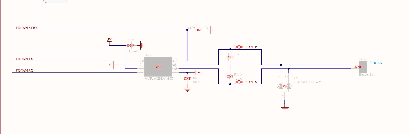

Additionally, is there an expansion board that offers a CAN interface for the C5AZG?

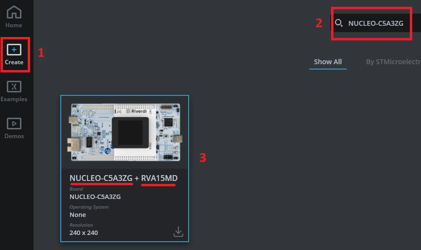

To me there is nothing preventing using NUCLEO-C5A3ZG with X-NUCLEO-GFX02Z. Need to confirm by checking the schematics.
But what is sure is that RVA15MD display extension board (by Riverdi) is supported by NUCLEO-C5A3ZG:
Proof: with TouchGFX designer tool when you select NUCLEO-C5A3ZG as a target board, you see this:
Hope that answers your question.

X-NUCLEO-GFX01Mx are only compatible with NUCLEO-64 boards while X-NUCLEO-GFX02Z are only compatible with NUCLEO-144.
For CAN, you need either to add an external CAN transceiver (to my knowledge no such expansion board offered by ST) or simply solder a CAN transceiver on the board. Not soldered by default:
