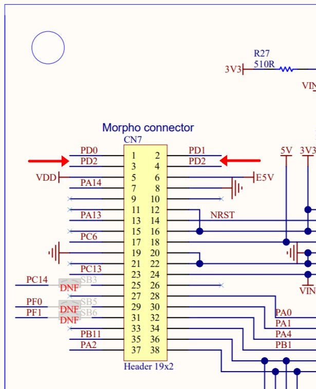

Hello @Karl Yamashita @Andrew Neil
After checking with our HW team, I can confirm that both connectors CN7-3 and CN7-4 are mapped to the same pin of the MCU (PD2).
Best Regards.

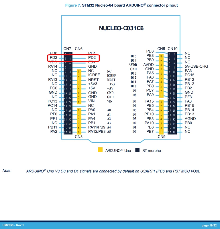

Andrew Neil
October 1, 2024
Fig 7 in UM2953 is the same:
PS:
PD3 is on CN10.1 both in schematic and in UM2953 Fig 7
Best Regards.
STTwo-32
Karl Yamashita
Principal
October 1, 2024
As @Andrew Neil, PD3 is on CN10, which i missed.
Though it doesn't make sense to have PD3 by itself when it could have been grouped with the other 3 PDx pins. Unless there is a reason to have PD3 on CN10?
