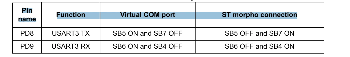

I am using a Nucleo 144 F767zi Board.
I am try to get any command on the Virt COM Console. But I failed always. I tried very lot things from on youtube, on the Forum ... but I always failed.
I see in the documentation
um1974-stm32-nucleo144-boards-mb1137-stmicroelectronics.pdf
6.9 USART communication
I see further that all pins are enabled by default. From my actual understanding, this means that the COM Port is not active because SB4 and SB7 are "ON" too?
Is this correct?
If this is true and I have to set SB4/SB7 off.
How do I set SB4 and SB7 to OFF.
I did found anything "how to change the state of a SB".
Thanks for any hint to get the Console running.

but the docu said:
For Virtual COM Port:
SB5 on AND SB7 off
SB6 on AND SB4 off
Very Important too, use PD8 and PD9 on USART3. Otherwise I will not work too.
Unsolder the zero-ohm resistor or solder bridging connection
Use a soldering iron, remove connection, or drag solder between the two nodes to connect them.
USART3 should work either way. This just allows you to disconnect wiring / connections if you add things to the board that clash with them.
Bring up USART3 peripheral and pin clocks, baud rate of peripheral.
The baud rate needs to match that of the COM port which you connect too in Windows

And please pay close attention: many YouTube videos just mention an UART that is connected to the ST-LINK on the respective board without explicitely stating U(S)ART2. However, the large NUCLEO-144 in particular often does not use U(S)ART2, but U(S)ART3, which you must of course take into account when programming.

today I remove the SMD 0 for SB4 & SB7 what means switch off these SB as described in the documentation,
This was a small mess and a jumper would be the much better solution.
But now it works directly. Now I can connect to the virtual console and see my printf messages.
I see that for some other F7 Nucleo Board the SB 4 & SB7 are switch off by default.
For the F676zi SB5,6,4,7 are all switch on by default.
But from my understand and if I read the table 6.9 (above) than the SB4 & SB7 must be switch off to get the Virtual COM Port running.
Isn`t ?
Anyway for me it is working now and Lesson 2 "Hello World" is done. ;-))

I don't know that they "need" removing, the signals are not high bandwidth (sub MHz). Removing them allows for deconfliction and prevents reflections on the lines, and functions other MORPHO cards might bring to the party.
I've not found a need to remove them from my collection of NUCLEO-F7xx boards.
SB5 on AND SB7 off
SB6 on AND SB4 off
