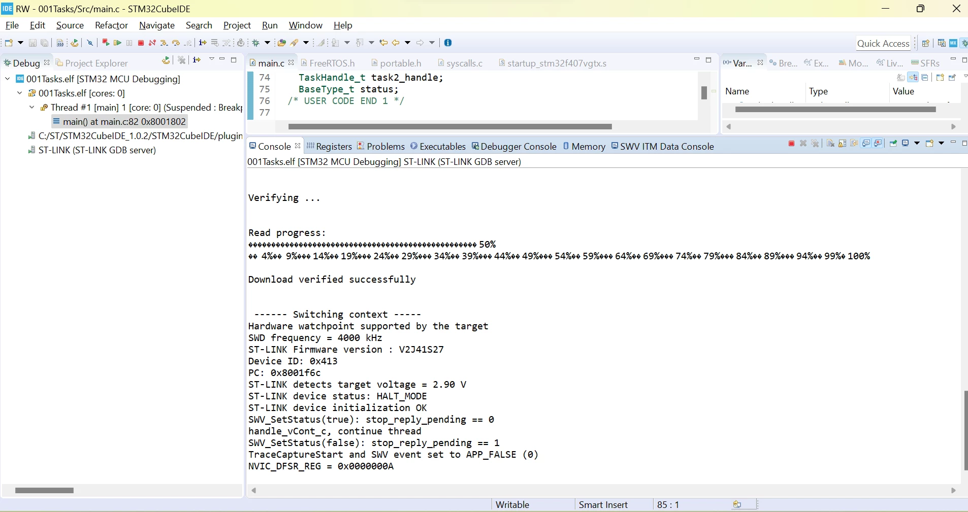

Not able to debug with STM32F07 dev board. Attached the debug log, kindly help me in this. Thank

4 replies
MM..1
Chief III
March 11, 2023
And what? Maybe you use pins in code = debug not possible or voltage unstable
ST-LINK detects target voltage = 2.90 V
ST-LINK device status: HALT_MODE
Tesla DeLorean
Guru
March 11, 2023
Which board and chip specifically?
Is it a low pin count device?
Can you connect under reset? Is NRST physically connected in your design?
Can you connect or adjust BOOT0 pin or settings?
Does your code interfere with the SWD pin configuration? Disable it, or go into a low power mode?
Problems are hard to troubleshoot without context to work from. Elaborate

Board : STM32F407VG MCU * New order code STM32F407G-DISC1
I am trying to integrate freeRTOS and run a sample program using SWD pin. I am getting the below error and log(partial)

Sorry, it is not SWV. Confiured SWO pin for supportinng printf style debugging
Rim LANDOLSI
April 4, 2023
Hello @SNaga.6​ ?
Could you, please, attach a screenshot of the debug configuration.
Thanks,
Rim
