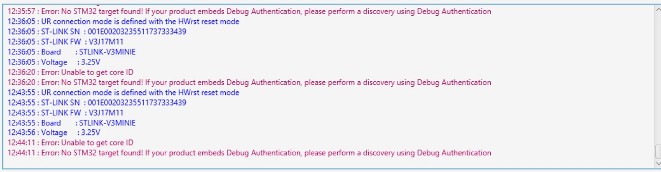

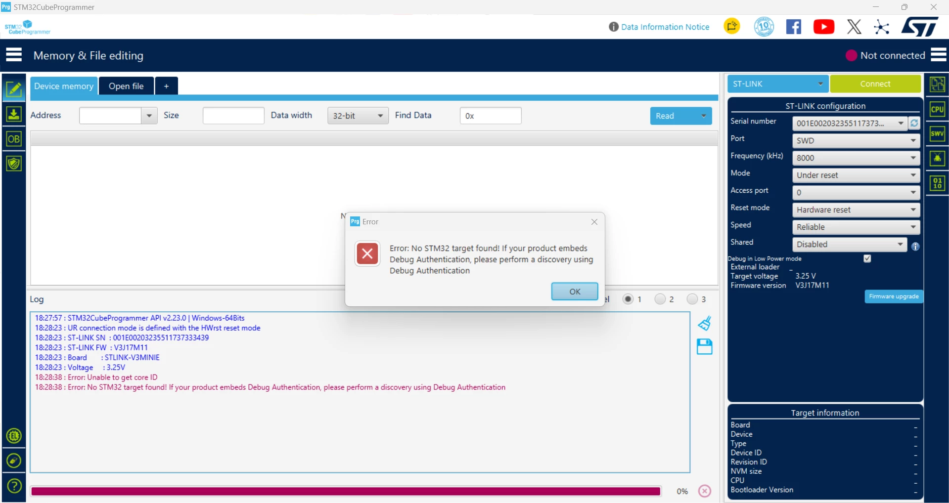

I am using ST link v3 mini when i try to connect the controller using the st link v3 it is showing as the
Error : unable to get the core ID.

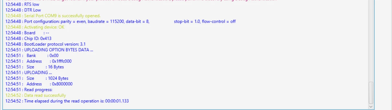

But when i try to connect the controller using the DFU mode.
i am able to connect to the controller and able to program the controller and option bytes are also AA(RDP 0)>.
What is issue why i am not able to connect to the mcu using the St link (SWD) but able to connect to the controller using the DFU mode.
is there anything i have to make changes in the cube programmer.

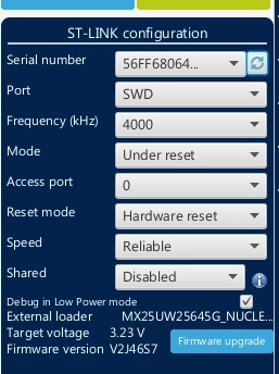

You need to have reset connected; and then BOOT0 low ;
then try to connect :  hw-reset + under reset - >
TejasKAuthorBest answer
Sep 8, 2026 1:02 PM UTC
I tried this also still it is showing
error: unable to get the core ID
I figured it that the clk pin is still 3.3v.
the SWCLK pin  is internally got damaged.
Maybe because of 2 reasons the SWCLK got damaged
1. i think because of the ESD surge.
2. Vdd is also next to the clk in the controller may
Thank you.
