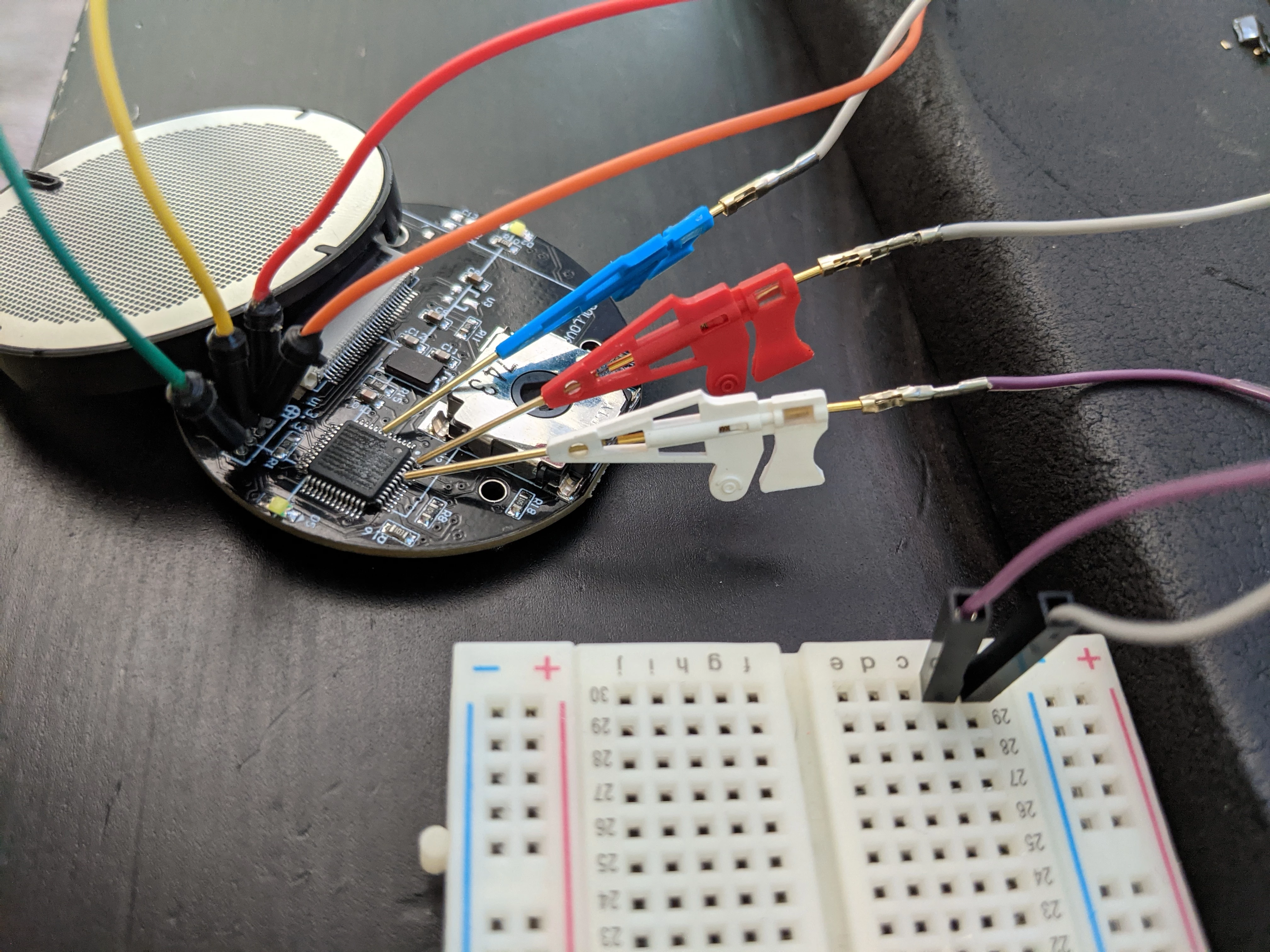

I'm trying to use a ST-LINKv2 to re-program a consumer device that I know has an STM32 of some kind inside (fairly sure it's a STM32L-something). I found four headers on the board that a continuity tester has shown to be Vdd, Vcc, SCLK, and SWDIO.
Connecting with only those 4 wires did not allow STM32CubeProgrammer to connect to the device. It gives the message "No STM32 target found!". Same with the ST-Link Utility. So I next tried tying boot0 high (w/ and w/out a 1k resistor). I have confirmed that this prevents the device's normal program from starting. Connection still fails. I then tried connecting NRST to the ST-LINK so that it could control hardware-reset. I can verify that trying to connect to the device does reset it over NRST. But it still can't connect

Just leaving a follow-up on this. I'm not certain yet whether the issue was with the RDP. I took the nuclear option and soldered a replacement MCU onto the board. It had the exact same problem (no target) until I found another tutorial on how to interface with bare MCUs. Video #5 in this post described how the SWCLK needs to be tied to Vcc, and SWDIO needs to be pulled to Vdd.
https://hackaday.io/project/25097-arm-microcontroller-bare-chip-tutorial-series
Adding that to the wiring setup allowed me to read from the new empty replacement.

SCLK/SWDIO are pulled up/down as needed internally, read the GPIO chapter in RM for your STM32. If external pullups/downs worked, it probably was coincidental or it masked some other problems. Long flying leads are often source of problems with high-speed signals, coupled with inadequate return/ground; and the breadboard is something I recommend to position strategically into the garbage pin.

Based on your comment, I decided to to a bit more fiddling. I've found that not having a pull-down on SWCLK ground did not affect things. However, with dozens of attempts either way, it can only read when SWDIO has a pull-up resistor.
Unfortunately without fabricating a custom connector, I'm stuck with the breadboard for now. Another thing I found is that selecting any frequency besides 4000kHz prevents reading. I thought selecting a lower frequency would reduce any signal integrity issues, but it does not connect when that's changed

It seems that you are correct. I did some googling on how to use openocd, and this blog post came up indicating that the target still needs external power
http://www.rudi-horn.de/Home/7-debugging-the-stmf-with-an-st-linkv-and-openocd
This is consistent with my experimentation. If I try to connect with openocd without a resistor, it gives me this output:

Note the warning at the bottom about the voltage (1.4v is definitely too low). It's not totally clear how a pull-up resistor on SWDIO would change that (brings it up to 2.8v according to openocd), but it does.
If I remove the pull-up resistor _but also_ touch the original batteries to the contacts, the power again comes up to almost 3v. Here's the output when it successfully connects:

False alarm! I accidentally had the reset jumper tied low from testing a previous theory. I can now read meaningful data.
