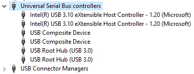

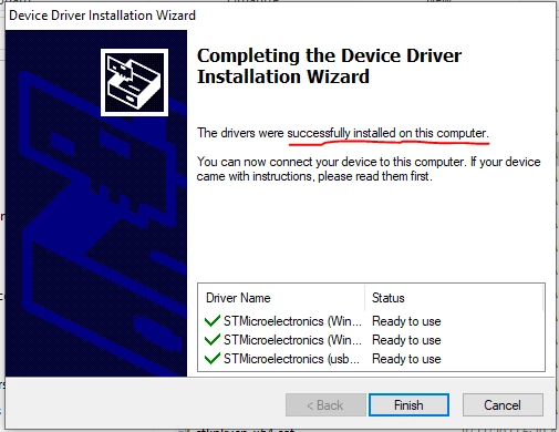

I used the STM32CubeIDE for 3 years on a Windows10 PC. After installing the 8-bit ST_Tools (STM8CubeIDE,...) on the same PC the connection to a NUCLEO-64 (STM32-G431RB) does no longer work. Now STM32CubeProgrammer reports "No ST-Link detected". However, I don't know if the STM8 installation is related to the problem.
Solution attempt: download and re-install the latest STM32CubeProgrammer (v2.11.0) ST-Link drivers (STSW-LINK009). The install wizard reported a successful driver installation (see screenshot). However, the issue"No ST-Link detected" persists, and new drivers are listed by the Windows Device Manager (see screenshot).
Please suggest potential solutions to try. Thank you.

Frequently no Data Wires, and non-shielded..
ST-LINK/V2 can be very erratic on hubs, appearing to fail or disconnect, especially on read heavy transactions, ie verify after programming on external QSPI devices (5-10 mins of 256MB interactions)

Hello @Kmax18​ ,
I recommend to check the USB cables, or try other USB cables.
Make sure to upgrade the ST-link firmware.

I had a similar problem.
Try to connect the ST-Link directly to an USB port of your PC, not over a hub or docking station.
Sounds strange, but this solved my problem.

Thank you, that worked, both the direct USB port together with a USB cable not designed for battery chargers. I did not know that USB charger cables are different from USB serial comm cables.
