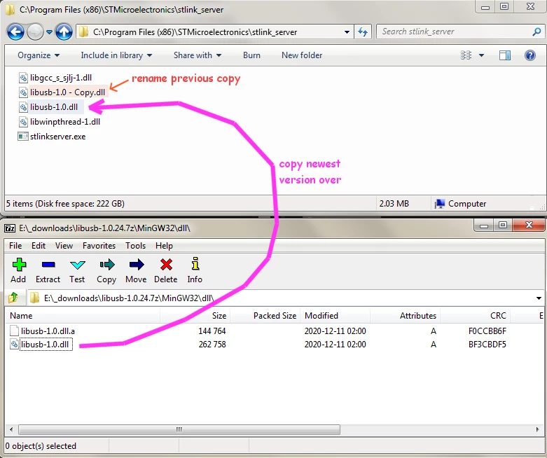

No ST-LINK detected! - STM32CubeIDE 1.6.1 - Win7 [SOLVED!] CubeProgrammer can see and program the board fine, CubeIDE won’t see the ST-LINK probe.
I’m preparing my computer for an upcoming STM32WB55 webinar.
For 3 days I have installed, uninstalled, system restore wipe, and re-install again the latest CubeIDE, CubeMX, CubeProgrammer, and ST-LINK “USB driver (STSW-LINK009) is for ST-LINKV2, ST-LINKV2-1 and STLINK-V3�?.
I created an example project; it builds fine, but at the time of debugging CubeIDE never sees the ST-LINK.
However I can take the resulting *.bin or *.elf from the project’s Debug folder and flash it with CubeProgrammer and run the example in the board (STM32WB5MM-DK in my case).
Also with CubeProgrammer I was able to upgrade the ST-LINK firmware in the STM32WB5MM-DK to the latest.
So although CubeProgrammer can see and program the board fine, CubeIDE won’t see the ST-LINK probe.
Please help.

Hey Laurent,
It seems the culprit is libusb. After reading similar posts, I decided to try the latest libusb.
I went out and downloaded the latest libusb 1.0.24 from /libusb-1.0/libusb-1.0.24/libusb-1.0.24.7z and copied the libusb-1.0.dll from the MinGW32\dll folder into the st-link-server folder "C:\Program Files (x86)\STMicroelectronics\stlink_server", kill the stlinkserver.exe process in task manager, and that did the trick!
Now my STM32CubeIDE 1.6.1 can see the debug probes using either the ST-LINK (ST-LINK GDB server) or ST-LINK(OpenOCD) probe options.
Laurent thank you for your pointing me in the right direction to find a solution.

Hey Laurent,
