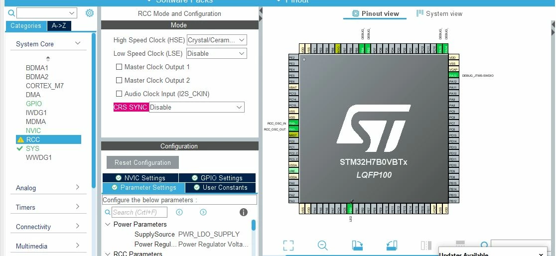

After selecting JTAG, it show some warning and i see red mark in rcc. if i put cursor it shows "crs sync conflict with DEBUG: Debug JTAG(5 pins)".
when i select low speed clock it becomes yellow. Please help me.

OK, I think you need to double check the pins used for JTAG that can conflict on RCC stuff.
Why do you want to use JTAG if SWD is working fine ?
SWD uses less pins (no need of JTRST or JTDO) and you can do SWV with SWO pin (JTDO).

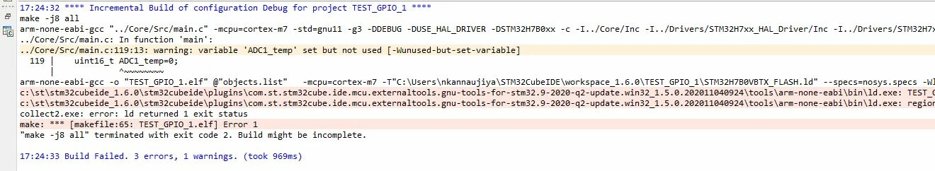

my Microcontroller has 1.4 Mb of RAM. I need 700 Kb. when i am exceeding 128 Kb it is showing error (RAM overflowed by 1904 bytes).
I have attached screenshot and one .txt file that has error message. please resolve this problem.0693W00000BaI3EQAV.jpg0693W00000BaI34QAF.jpg

This is already a monstrously long thread, honestly got a NEW problem, start a NEW thread.
The 1.4MB is likely NOT contiguous, you're going to need to define the different spaces in the Linker Script (.LD) or related UI, and then direct content into the various RAM regions depending on appropriateness, either at an object/routine level or via the attribute directive.
