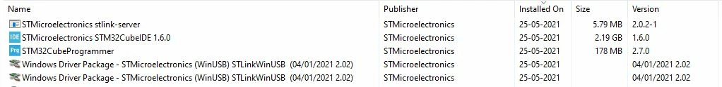

NKann.1
NKann.1Author
May 25, 2021
usb driver has been installed ,it is showing in control panel but not in device manager.0693W00000APhflQAD.jpg
LaurentL
May 25, 2021
OK, fine with the STLink drivers.
Did you try with another usb cable ?
I suppose it is the same result with STM32CubeProgrammer, no STLink detected ?

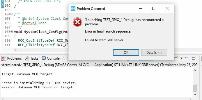

NKann.1
NKann.1Author
May 26, 2021
problem was the USB cable.
Now it is resolved.
Now new error is coming0693W00000APpebQAD.jpg.
LaurentL
May 26, 2021
Ok, then this time it's maybe a fault in wiring or on your custom appli board.
Why can't you try in SWD mode ?
All the pins that are needed to do JTAG are ok for SWD.
Check all the VDD (VCAP if any) and the Analog supplies and Gnd.
Did you connect the STLink reset pin to NRST pin of device ?
Check with STM32CubeProgrammer if you can detect the Mcu.
Don't let the STM32CubeProgrammer connected if you want to retry debug with STM32CubeIDe.
What is your mcu device VDD value ?
STLink V3 Set has not the level shifters so if your appli board is not powered at 3.3V, it might be an issue.
Do you power the appli board with an external supply ?
I don't think the STLink V3 can supply your board.
Can you share the stlink connections ?
