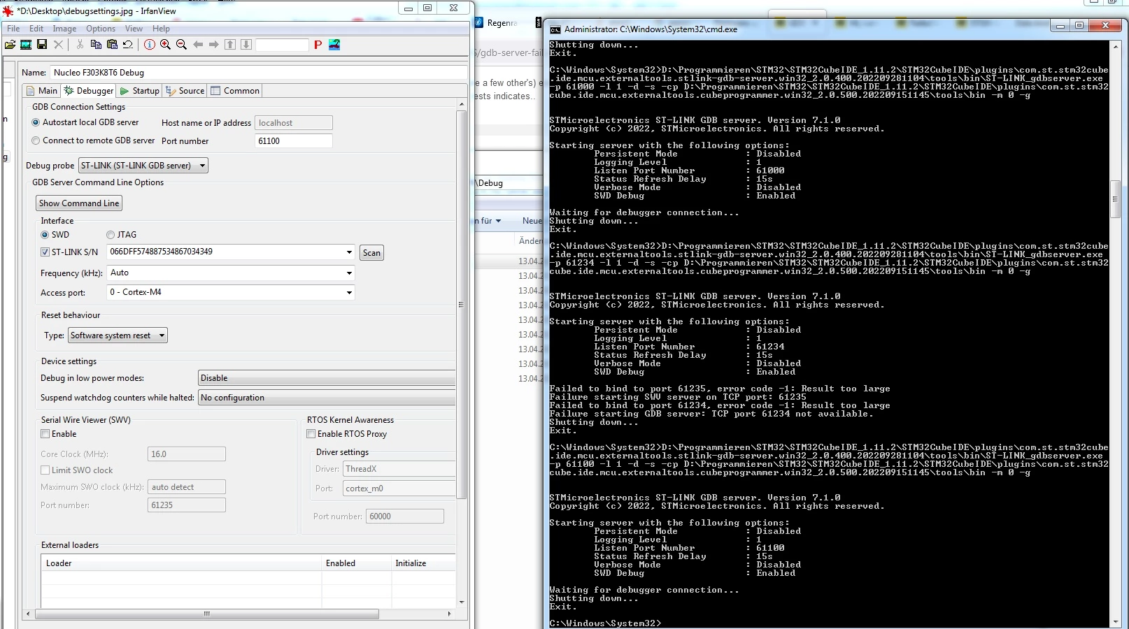

I already spend many hours trying to figure out why flashing the nucleo does not work.
What i found out so far:

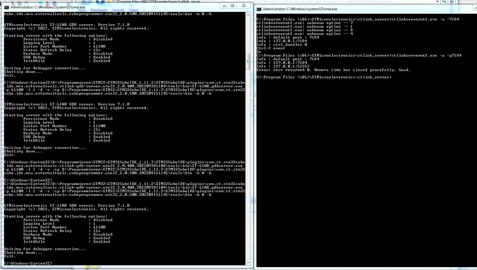

ST-LINK_gdbserver.exe is not started from IDE. Starting it with the copied commandline, it only works with a port other than the default one. When it is started, the LED of the nucleo starts flashing green/red (!).
I can launch stlinkserver and gdb server, so that they are running, but still i got the problem. I already tried many options as openOCD, checking the ST-LINK S/N box and scan inserted a longer number. Also tried all resetbehaviours. Log to file did not create a file from gdb-server and shared ST-LINK did not change the outcome.
Changing the frequency did not work either.

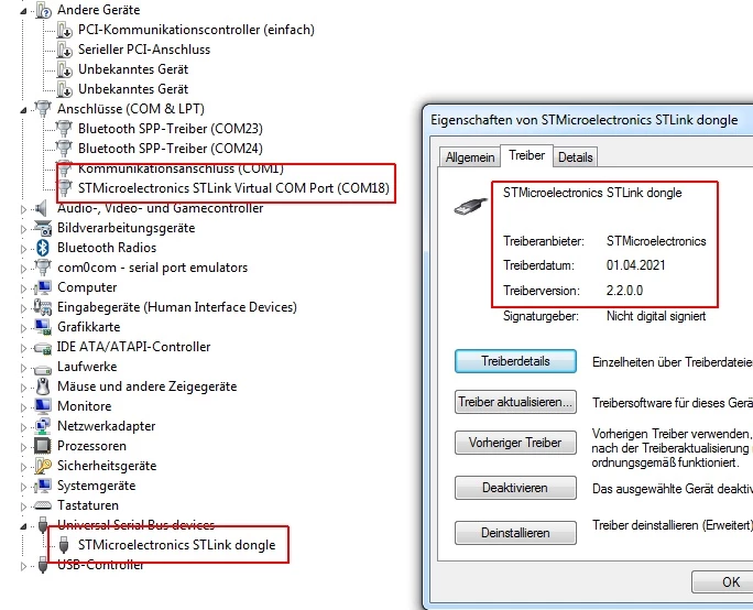

The firmware of the stlink is V2.J42.M27.
Also i updated the firmware to exclude mass storage.
stlinkserver is started from the IDE with "-a -p7184".
This error message is really lacking with some more details. Maybe there is a log for it somwhere?

I found the problem, and a work around after like 14 hours of trying:
The problem is the gdb server, that is not started with the standard settings. But when you copy the gdb command, and execute it in a seperate cmd, and choose remote gdb server (changing the port might be needed too!), it then works! Now i just need to automate the manual starting of the gdb server. But i ran out of juice for now ;)

I could get some debug from the stlink server. It seems that the st-link can not be detected, but with the firmwareupgrade tool it works.

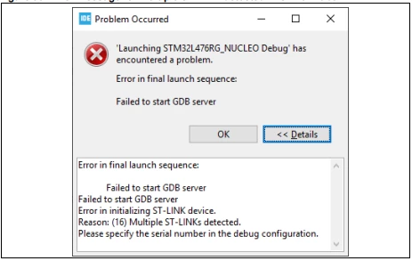

Hello @tobias Köhler​ ,
Try "Connect under reset" mode.
I advise you to refer to this FAQ: How to solve debugger connection issues.
If you try to launch a debug session with two ST-LINK connected, a pop-up message appear as shown in the figure below:
_legacyfs_online_stmicro_images_0693W00000bi5aFQAQ.pngPlease refer to AN4989 and precisely Appendix C Managing various targets on the same PC/ STM32Cube IDE section.
I hope this help you to solve the issue!
