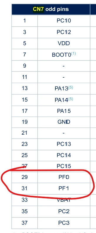

No PF0 or PF1 on NUCLEO-H533RE!!!
No PF0 or PF1 on NUCLEO-H533RE even though the schematic and documentation show PF0 on CN7 pin 29 and PF1 on CN7 pin 31.  Are pins 29 and 31 connected to anything or is this a documentation error?

As shown in both the user manual and the schematic, pins 29 and 31 of CN7 are connected to PF0 and PF1, respectively.

The NUCLEO-H533RE is populated withH533TM32H533 which does not have PF0 or PF1 pins.

H533TM32H533 (64 pin)

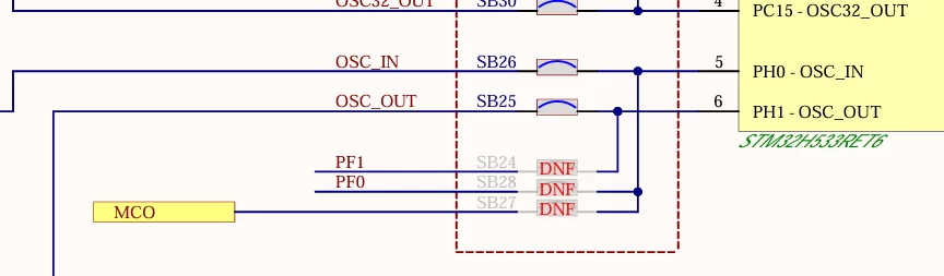

Aug 27, 2026 10:13 PM UTC
You’re right. The “PF0/PF1” nets are secretly just PH0/PH1 through a (default open) solder bridge.

Aug 28, 2026 2:03 AM UTC
I could have gone blind looking for those labels.  Why did they not call them PH0 and PH1?

Aug 28, 2026 3:28 AM UTC
Just a mistake or oversight probably. That board is used for multiple different chips, some of which likely have PFx.
You can use Ctrl+F to search for “PF0” in the PDF rather than just browsing.
