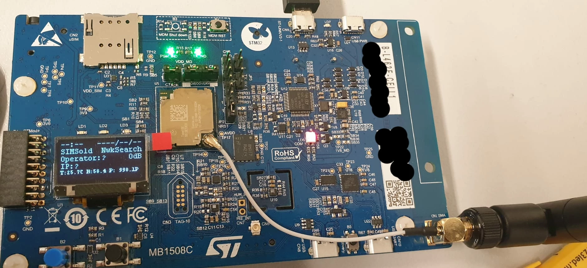

Hi fellow engineers,
I have followed the steps in the manual and also in the 'Cellular X-CUBE-CELLULAR How To'. But after 30minutes still no connection. I uploaded the bin-file from --> ...\Projects\B-L462E-CELL1\Demonstrations\CellularIoT\..
in short i get errors like(full log found in attached-file):
  • CST_modem_sim_init : Can't find sim on current slot. Increment sim slot.
    =====>CST_notif_callback (Data Cache event=4)
    CST_modem_sim_init : Reboot modem.
    === CST_modem_sim_init Fail !!! ===
  • ATCModem:NetworkState (EPS) = NOT_REGISTERED_SEARCHING
    ==================================CST_network_reg_callback
    <CR><LF>
    +CREG: 2<CR><LF>
    ATCModem:NetworkState (CS) = NOT_REGISTERED_SEARCHING
    <CR><LF>
And no name of the operator or IP on the OLED(see attached file)
Thank you in advance.
Fazil
