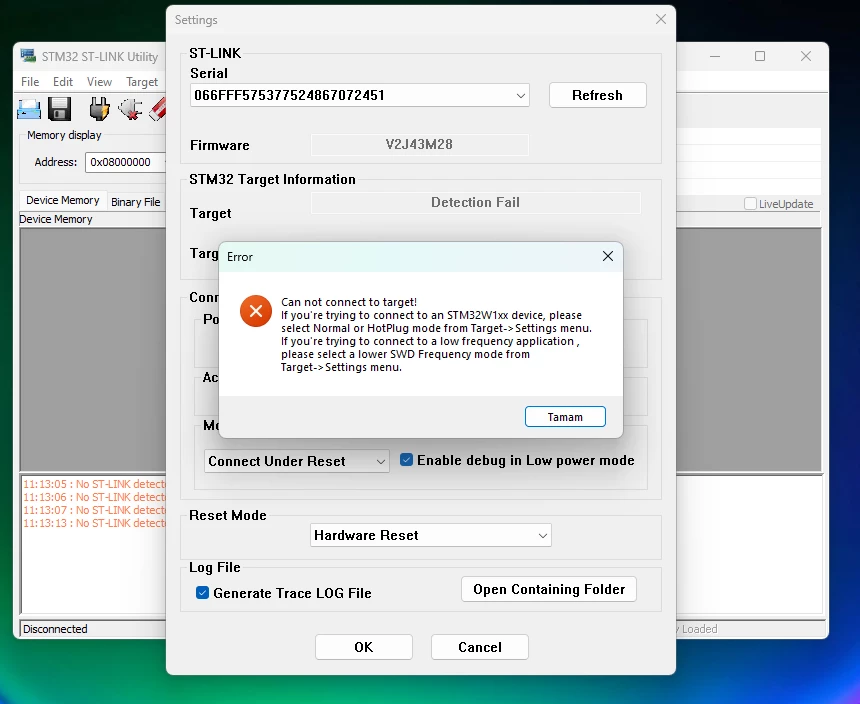

hi, i got this error on stm32cubeide. I've used my board 3 weeks ago. I can't neither start the program I loaded before nor load the new program. can see Stmicroelectronics STLink Virtual COM Port COM 5 on device manager. how to solve this problem?

Please check that the jumpers are correct on your board, especially the one for the ST-LINK.Then, try to connect your board with STM32CubeProgrammer. In the ST-LINK configuration area, try the following configuration:
  • Serial number: Refresh to get your ST-LINK serial
  • Mode: Under reset
  • Reset mode: Core reset
Finally, try to connect your board.

What should I do?
STTwo-32
April 6, 2024
ST-LINK Utility is obsolete. You have to use the STM32CubeProgrammer.

How can I use CubeIde?

Which board are you using? The DISCO or NUCLEO? Something else?
Make sure the pair of ST-LINK jumpers are in place.

Discovery and jumpers are in place.
