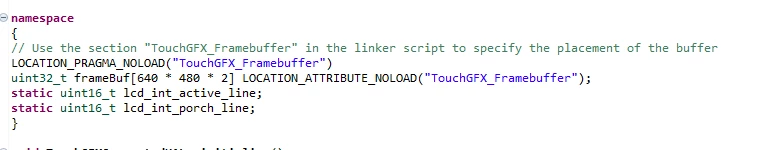

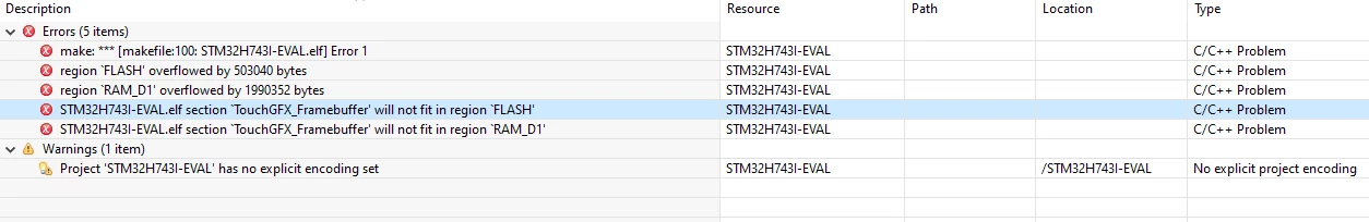

AnupurbaAuthor
January 17, 2024
I have followed each and every step of this video, but it is giving me a SDRAM overflow Error.
Version of STM Cube IDE used: 1.14.0
This is the generated file where error has occurred. File name: TouchGFXGeneratedHAL.cpp
