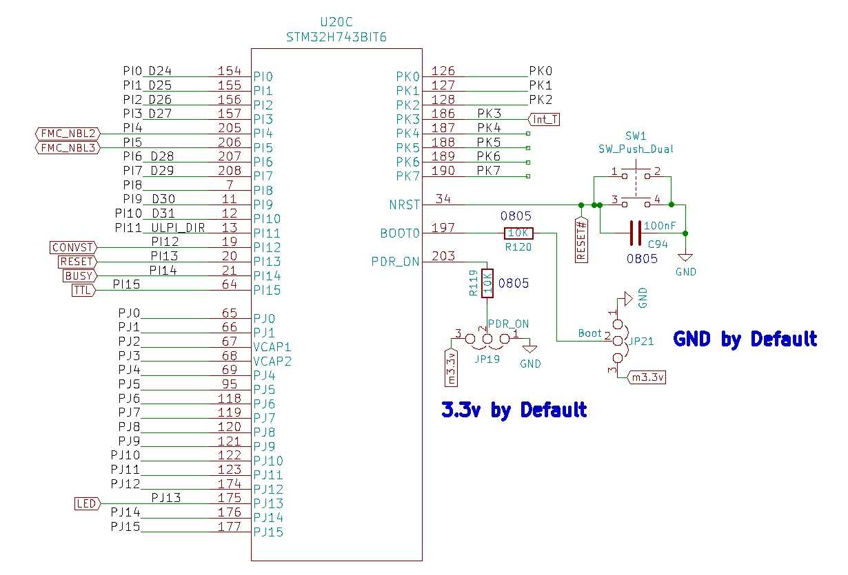

Hi Everyone,
Hope you are doing well.

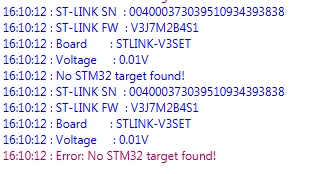

I am not able to connect my new custom board based on STM32H743BI with STM32CubeProgrammer using STLINK-V3SET. and get the "Error: No STM32 target found" when i try to connect.
0693W00000ANkMsQAL.pngAs suggested in different threads i have confirmed the following:
  • Reset is pulled high
  • Boot0 is pulled low

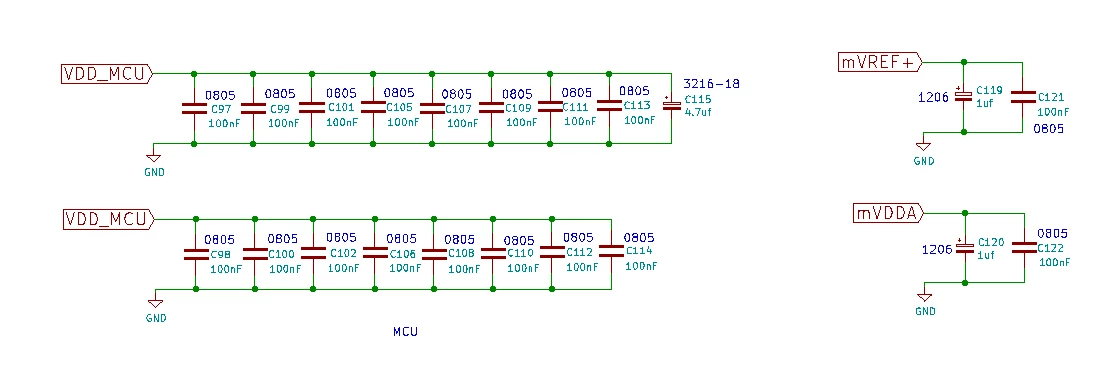

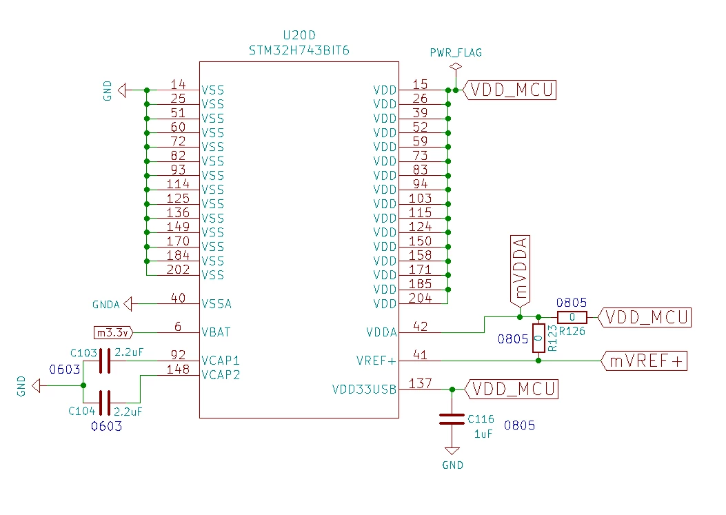

  • VDD is stable at 3..28V at all desired pins of the board
  • VCAP 1&2 connected to 2.2uF capacitors showing voltage of 1.01V.
  • VDDA is 3.28V, VSSA is Grounded,
I am using a 10 pin SWD connector.
The Circuit diagram is shown below
0693W00000ANkNWQA1.png0693W00000ANkNgQAL.png0693W00000ANkOAQA1.png0693W00000ANkNlQAL.pngThanks,

You made my day.
it was the problem of connector footprint. it was supposed to be mirrored vertically. Now i am able to connect and programmed the MCU.
Thanks again
Uwe Bonnes
Chief
May 9, 2021 10:40 AM UTC
J10 seems inverted to most other SWJ 10 pin layouts.
