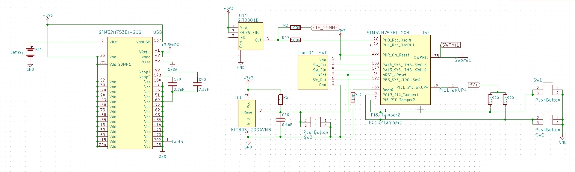

You just need the SWD conector, 5 or 6 pin, I use 6 if there is room.
then just some bypass caps, its pretty easy...
just be sure you have enough Caps...
I tend to install many caps, and you can test with and without ,
then not install some of them in production.
Low ESR caps are needed for the Vcap1 and Vcap2.. but it seems to work easily, the chips are very good.
Here is part of the H7 board that runs..
T J
Senior III
October 30, 2018
