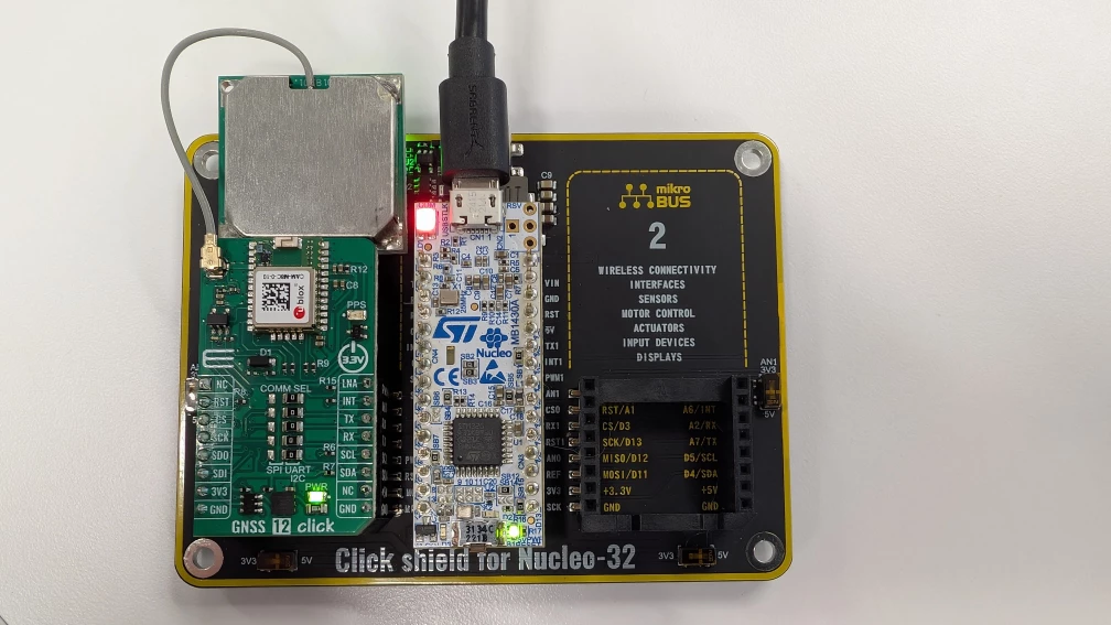

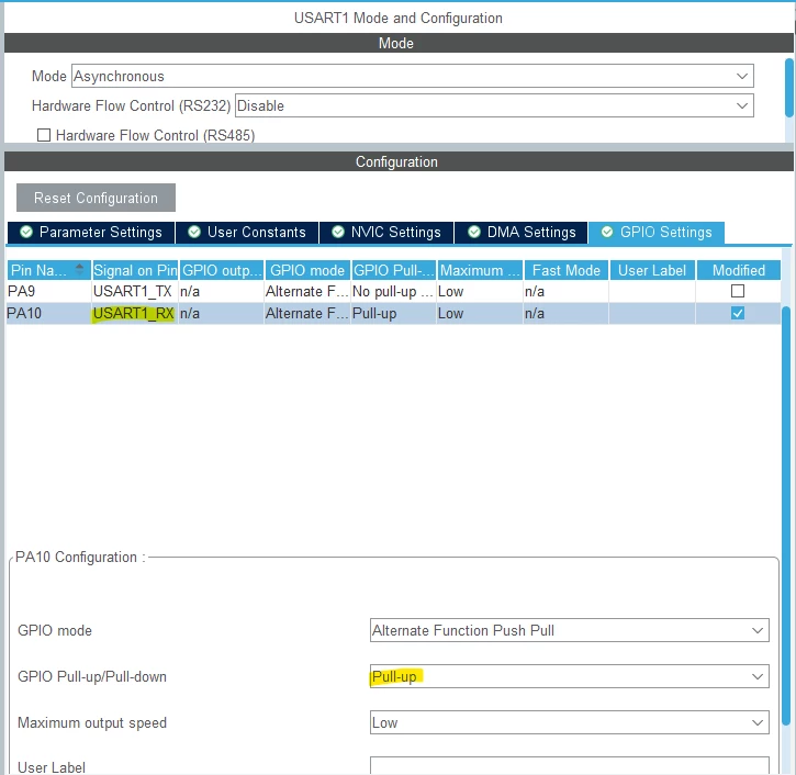

my UART interrupt doesn't work
I am working on a project with a Nucleo-G431KB. I am using UART1 to receive GPS data (LEA-6S module, 9600 baud, 3.3V) on pin PB7 (RX), and I send data to a LoRa module (Ebyte E32868T20 module, 3.3V,  9600 baud too) on PB6 (TX).
I configured UART1 in asynchronous mode with interrupts enabled (USART1 global interrupt active).
In my code, I call HAL_UART_Receive_IT(&huart1, &recep, 1) at startup, and I relaunch HAL_UART_Receive_IT at the end of HAL_UART_RxCpltCallback().
The GPS sends data correctly (tested with a direct connection) and the lora module works too (tested by sending text every 3 seconds), but on the Nucleo, the UART interrupt never seems to trigger.
I give you my main.c and my .ioc file
Any idea what could block the UART RX interrupt on the G431KB?
Thanks!
tibaalBest answer
May 26, 2025 2:01 PM UTC
I FOUND WHAT WAS WRONG
it was the function BSP_Led_Init(LED_GREEN),
Without it all is good
Thank you all

basically it should work, but :
- did you enable callback in Cube ?
- on any error uart will stop working - and then..?
You need callback on receive + error :
void HAL_UART_ErrorCallback(UART_HandleTypeDef *huart)
	printf("UART7 error testvar hex %ld \n ",testvari);
	// *** ... try again
	HAL_UART_Receive_IT(&huart7, &ESP_RX[ESP_RX_COUNT], 1);
tibaalAuthor
May 7, 2025 12:59 PM UTC
thank you but this solution doesn't seems to work. I modified my program since last time, here it is.
the principal evolution is that I use UART1 for the GPS and UART2 for the Lora module. (I have also I2C for a C02 sensor but I don't use it for the moment).
I enabled callback and put this error function. I don't have any results, I don't recieve any message that indicates that i went in my interrupt.

@tibaal You might be onto something.
I have the Nucleo-G071RB that I've written code for and using a GPS Click module. There were never any hiccups with the FW running correctly.
I now have this setup as shown below. I ported the code over from the G071RB to this G431KB project. I do see that the NUCLEO-G431KB does not interrupt consistently every time I plug in the USB connector. I have the FW pass data from the GPS(USART1) to the VCP(USART2). Sometimes the GPS will interrupt and the code will pass the strings to the VCP port and sometimes it doesn't interrupt.
At the same time, I could never get the VCP to receive commands after plugging in the USB connector. I have to push the reset button on the Nucleo and most of the times the VCP receives commands just fine, but then the GPS doesn't interrupt.
To get both USART1 and USART2 to interrupt consistently, I just enabled pull-up on the RX pins. So give that a try to see if you get interrupts working.
I should test if the G431RB shows the same behavior as the G431KB.
