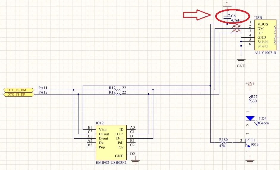

As I'm now done with the development of the main firmware for my product and ready to move my design to a custom board, I thought it might be worthwhile to make a checklist of the most important things to be considered by the designer in order to avoid confusion and troubles at a late stage of the production.

2- USB Device circuit
I started by reading AN4879 (USB hardware and PCB guidelines using STM32 MCUs).
I will need USB in device-mode only for MSC, no host, so I have disabled the VBUS sensing, ID signal, and removed U6 (STMPS2141STR) from the board so I can test if it affects the enumeration of the device on the host PC. Everything works fine, device is enumerated and I can access the storage medium (uSD card) read/write on the PC, however, the performance is terrible. It takes roughly 10 seconds to write 1.4 MBytes to the card over the USB connection. I don't know if there's any way to make it better. So, in my custom board, there won't be VBUS sensing, ID, as well as, overCurrent (STMPS2141STR). By the way, PD5 is used by the FSMC and LD8 always flashes during access to the external memory-mapped device. Since there's no use for these signals in my application, I assume it's safe to eliminate them altogether on my custom board. This is how the USB circuit looks like now:
I believe cap C6 is also not needed anymore since U6 is no longer there.

I'm open to comments, suggestions, or any input that could help me avoid any issue before production of final board.
